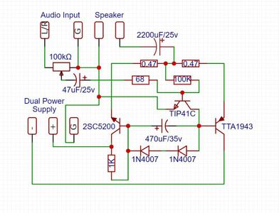

Step 4: Schematics and PCB Design
Here we used three transistor to make this amplifier circuit. To adjust the sound system I have used volume control potentiometer. To operate this amplifier circuit, you can use only DC-12v power supply circuit or a high ampere 12v battery.
The schematics of PCBs can be seen above.
You can download the PCB Gerber, BOM, and "pick and place" files of this amplifier circuit PCB from the following link: https://github.com/creativeworldpro/How-to-Make-Powerful-Amplifier-Circuit

Step 6: Step - 1 (Connect Resistor With Circuit)
To make this amplifier circuit, 1st we connect resistor with the transistor. We are using five resistors to build-up this circuit.
We connect 100 KΩ and 68 Ω resistor with "Base" leg of Tip41C transistor. Then connect 1K resistor with the "Collector" leg of 2SC5200 transistor.
Then we will connect wire wound resistor with the circuit. We connect one resistor with "Emitter" leg of TTA1943 transistor and another resistor with "Emitter" leg of 2SC5200 transistor. Now connect this resistor empty terminal with each other.
Step 7: Step - 2 (Connect Capacitor With Circuit)
Now we need to connect capacitor with the circuit. To make this circuit we are using 2200µf/25v, 470µf/35v and 47µf/25v capacitor. First we connect 470µf/35v capacitor negative leg with "Base" leg of TTA1943 transistor and the capacitor positive leg with "Base" leg of 2SC5200 transistor.
Secondly we connect 2200µf/25v capacitor positive leg with 0.47Ω resistor and the capacitor negative leg will be connect with the speaker.
Then we connect the rest capacitor positive leg with the empty terminal of 68 Ω resistor and the capacitor negative leg will be connect with potentiometer ground leg.
Step 8: Step - 3 (Connect Rectifier With Circuit)
This time, we will connect rectifier diode with the circuit. We connect one rectifier positive leg with "Base" leg of TTA1943 transistor and another rectifier negative leg with "Base" leg of 2SC5200 transistor.
Then connect both rectifier empty terminal with each other. You also need to connect Tip41C transistor "Collector" leg with "Base" leg of TTA1943 transistor.
Step 9: Step - 4 (Connect Speaker With Circuit)
For output sound, we need to connect sound speaker with the circuit. We connect sound speaker one terminal with "Emitter" leg of Tip41C transistor and the rest terminal we connected 2200µf/25v capacitor negative leg.
Step 10: Step - 5 (Connect Audio Source With Circuit)
For input audio, now we need to connect audio source with the circuit. For audio source, we are using mobile audio jack, for that we need to connect an audio input cable with the circuit.
We connect audio input "L/R" cable with potentiometer input leg and audio input cable "G" cable with "Emitter" leg of Tip41C transistor.
Step 11: Step - 6 (Connect Power Source With Circuit)
To complete total process, now we need to connect power source with the circuit. For power source we are using dual power supply with the circuit.
We connect power source "Positive" cable with "Collector" leg of 2SC5200 transistor, then connect "Negative" cable with "Collector" leg of TTA1943 transistor and connect power source "Ground" cable with "Emitter" leg of Tip41C transistor.
