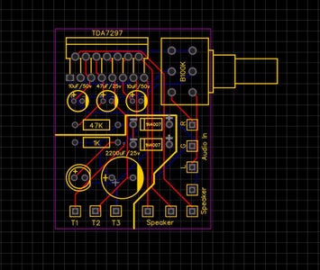

The Design of amplifier circuit along with the PCB layout can be seen above. Power supply included with the circuit. You can use any 12 battery for this amplifier project circuit.

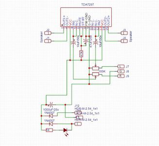

Step 4: Schematic of Amplifier Circuit
The schematic of heat sensor circuit along with the PCB layout can be seen above.

Step 6: Connect Capacitor With Circuit
To make this amplifier 1st we connect capacitor with the sound IC. The sound IC contains 15 legs. There are some common connections in these 15 legs. 1st We connect sound IC 3no leg with 13no leg, 4no leg with 5no leg, 6no leg with 7no leg, 8no leg with 9no leg and 11no leg with 12no leg.
Then connect 10µf/ 50v capacitor positive leg with 4no leg of IC and other 10µf/ 50v capacitor positive leg with 11no leg of sound IC.
Now connect 47µf/ 25v capacitor negative leg with 8no leg and it's positive leg with 7no leg of sound IC.
Step 7: Connect Resistor With Circuit
This time we connect 47 KΩ resistor with the circuit. We connect this resistor with 6no and 13no leg of sound IC.
Step 8: Connect Sound Speaker With Circuit
For output audio, now we need to connect sound speaker with the amplifier circuit. We connect left side speaker with 1no and 2no leg of sound IC, then we connect right side speaker with 14no and 15no leg of sound IC.

Step 9: Connect Potentiometer With Circuit
To control audio, now we need to connect potentiometer with the circuit. We connect potentiometer ground leg with 9no leg of sound IC. Then connect potentiometer audio in left and right side leg with both 10µf/ 50v capacitor negative leg.
Step 10: Connect Audio Jack With Circuit
For audio source now we need to connect audio input jack with the circuit. We connect audio jack ground cable with 8no leg of sound IC and audio source left and right side with audio Input leg of potentiometer.
Now we need to connect power source with the amplifier circuit.
Step 11: Make Power Source (Step - 1)
To make this 12 power supply circuit, we are using 1N 4007rectifier diode. We connect two rectifier diode cathode terminals with anode terminal of 1000µf/ 25v capacitor. For power indicator we are using 5mm LED light.
Step 12: Make Power Source (Step - 2)
Now we connect 5mm LED cathode terminal with anode terminal of rectifier diode. Then we connect 1k resistor with anode terminal of LED and resistor’s other terminal with cathode terminal of that rectifier diode.
Step 13: Make Power Source (Step - 3)
For input voltage we are using 12.0.12v transformer. We connect this transformer secondary section 12v cable with anode terminal of rectifier diode and transformer (Ground) cable with cathode terminal of voltage regulating IC. Then connect a AC cable primary section of transformer and connect AC cable with (220 ac) voltage.
Step 14: Connect Power Source With Amplifier
This time we need to connect power source with the amplifier circuit. We connect power source positive cable with 3no leg sound IC and negative cable with 9no leg sound IC.

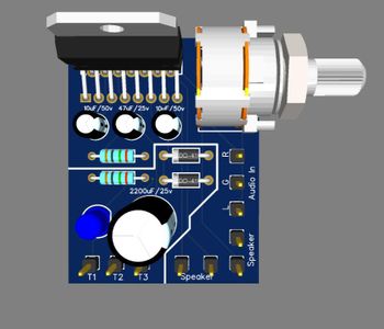

Our amplifier circuit is now completely ready for use. Before use, we might need to use heat sink with the sound IC.
Step 15: Soldering and Cleaning
Neat and perfect soldering is an important part for all kind of PCBs. Since soldering, you should remember that, there should not be any kind of short circuit connection. After soldering all leg, we cut-off the extra leg of all electronics component.
We also can use liquid PCB cleaner to clean the PCB board.
