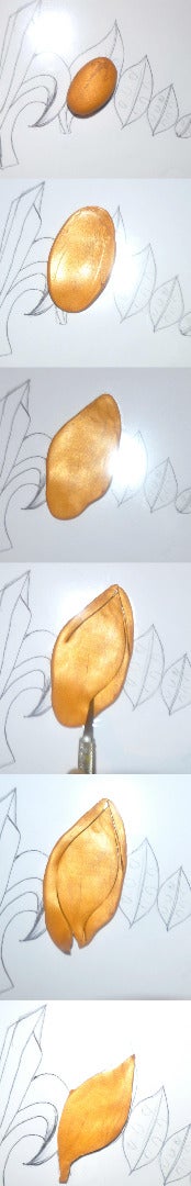

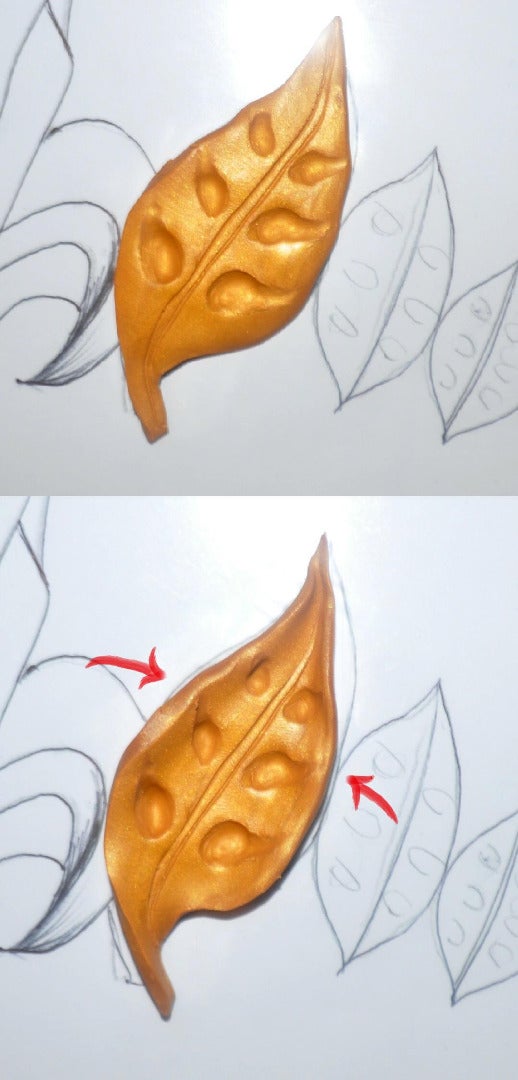

Start by rolling the clay into a sheet (approximately 2mm thick) and use a hobby knife to cut a leaf shape.
Use a toothpick to carve 2 center vein lines on the leaf. Use a ball tool to carve 3 spots on each side of the leaf. Slightly widen the dots in an upward motion as shown in the picture.
Once your done sculpting the leaf, slightly "curl" the side of the leaf as shown in the pictures, to give it a more delicate shape.

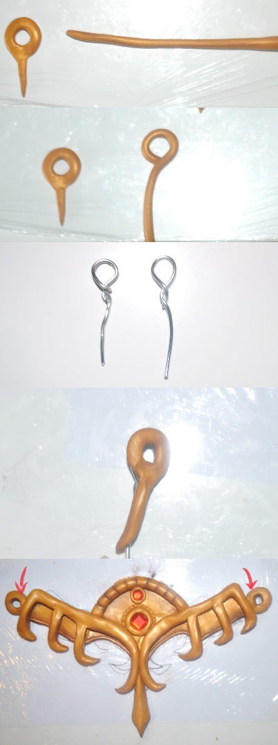

Roughly make eyelets in aluminium craft wire and cover them in polymer clay. These rivets will be quite usefull to connect the medallion to the armor.

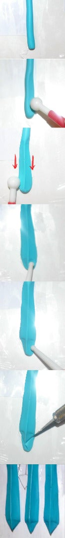

You can sculpt the blue teardrop jewels by making several log shape in blue polymer clay. Then use a ball tool to carve the facets as shown in the pictures.

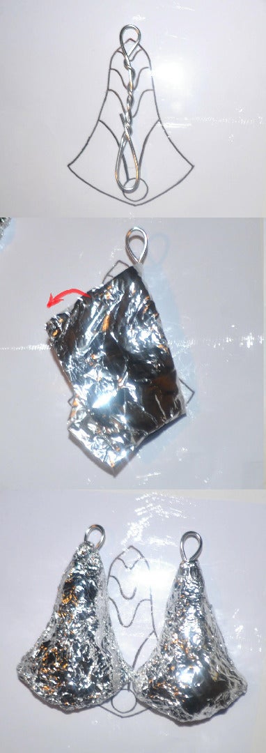

Make a base structure with aluminium craft wire, and make 2 pear shapes out of tin foil.
Roll a pancake of polymer clay and cover the « aluminium pears » starting at the front. Smooth the clay with a ball tool. Use a toothpick to carve the design as shown in the pictures. Place the blue rhinestone and gently press it on the clay to make sure it stays in place.
