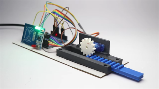

The project main part is the open and close mechanism that is controlled by the servo, and the mechanism hardware is made with 3d printed parts to keep the system running without any obstructions.
In simple ways i will explain how this project works
There will be unique tag that you need to keep safe because this is your key to access the door, If you tap on the scanner with this key there will be green light and the servo opens in other way the door lock is open and this is achieved by gears that moves the slider in and out.
On the other way round if the wrong id is tapped the red led glows and there will be no movement in the servo.

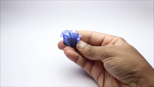

Micro Servo plastic geared

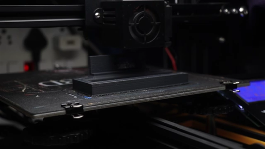

Step 1: 3D Printing
You can see that this is the part that enables the lock and unlock mechanism and will let you open and close the door, To make this work without any errors this part was made with 3d print.
You can simply go below and find the attached stl files, import them to curea slicer and print them.
Since the parts are simple there is no need of using rafts or support at the time of printing, you can simply follow the settings that i have given from the cura application and head over to printing

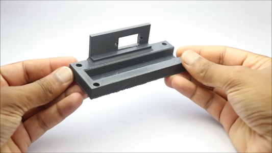

There are total 3 parts that needs to be 3d printed, the first one is the actual main body that holds the slider with teeth and also the servo, I used PLA filament to print the parts and the choice of color is left to you.

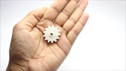

Second part is the Gear that will be attached to the horns of the servo that will control the movement of slider in and out when the servo is activated.

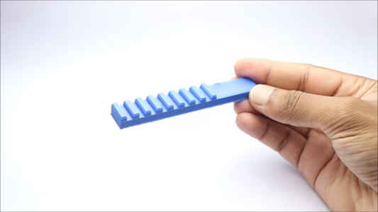

The third is the slider with the teeth, this teeth aligns with the gear teeth thereby taking the control of entire system.

Servo Motor Connections, the servo has 3 pins and we are connecting as follows
  • Signa to Digital Pin 3
  • VCC is Connect to 5V on the Arduino
  • GND is Connected to GND on the Arduino

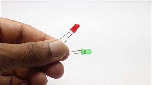

LED Connections
We are using 2 types of LED, one is red and the other is green
Green is connected to d5 and the red to d4, Note that these are for positive pins
The other leg that is negative is connected to gnd on the uno, if you think you have no pin for the connection you can combine the gnd pin of servo and LED together.

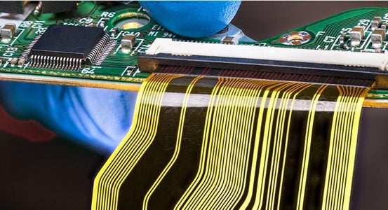

Check Here for Rigid-flex Pcbs with this your circuit becomes flexible! I have added the images to this step kindly check.
A revolutionary solution that combines the best of both rigid and flexible circuitry to elevate your electronic projects to new heights.
With their expertise in advanced manufacturing techniques, they offer a seamless integration of rigid and flexible components, ensuring enhanced reliability, durability, and space-saving benefits.

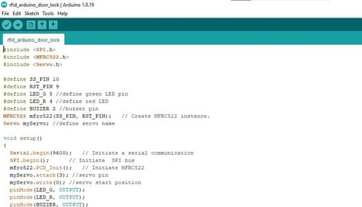

Step 3: Arduino Code
This is the arduino program we will be using in this project, You can simply download the code from below and paste it on the arduino IDE.

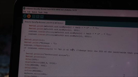

After you upload the code there is one important step that you need to do to make this circuit work.
Open the serial monitor, select proper port and type of board and click on upload, Now again open serial monitor and you should see a message asking for tapping the tag on the scanner.
Copy this ID and paste on the actual code by replacing the old id in the code with yours.
Now you should again reuplaod the code and then disconnect the power cable.

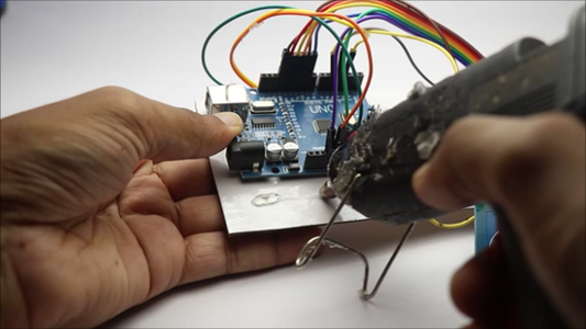

Step 5: Electronics
I will place all the electronics on a piece of cardboard, to begin with i will place arduino and to couple this instead of using hot glue i recommend to use double side adhesives.
To add the scanner you can select your best place but in my current setup i thought the side are the best places since it is clearly visible and there is no risk of touching wires when its working.
You can also replace this cardboard with wood or 3d printed base, anyways you can also add this directly to door using adhesives.

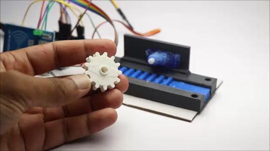

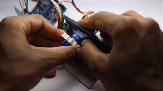

Step 6: Assembling Mechanism
To add the 3d printed mechanism that control the open and closing of the lock we can either add it directly to the door but it makes difficult to demonstrate to you so i placed all these on a cardboard.
Use hot glue to stick the main body, Now insert the servo to the dedicated slot and finally add the gear and the slider to this.
Now the project is ready for testing all you have to do is power this and tap on the scanner with tag and any one of the 2 instances will happen like given below.
To have an Authorized Access a registered card should be scanned, the green LED lights up, and the servo unlocks the door.
Unauthorized Access is when an unrecognized card is scanned, the red LED lights up to indicate that access is denied.
