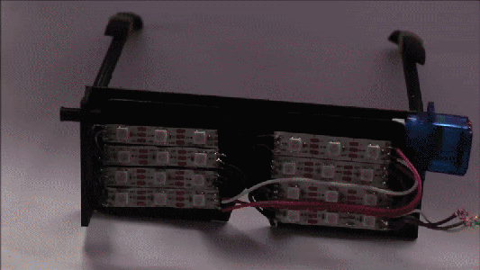

One thing here that you need to make a note of is the LED strip is straight and to fit this square frame you need to cut the LED.
I cut 8 pieces and each had 3 LEDs in them and the double side adhesive behind those LEDs will help you to glue them directly to the frame base without any hassle
Make sure you take care of the direction of the signal inside the LED strip, It should follow the arrow
Soldering will take time and after connecting each alternate strip check for the soldering connections.
It took me around 30 minutes to solder everything and check for the connections simultaneously. After you make all the soldering in the end for the input for the strip connect the jumper cables.

Now after you work on the one side(elevated) for the other side i will simply use the micro servo, these act as a hinge and solve many complications whihc in the other hand may have arised if i went with some other alternatives.
Glue the servo to the other side and now place the part that has the LED strips, After this is complete we can head over to uploading code.
