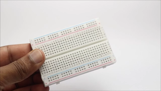

Breadboard

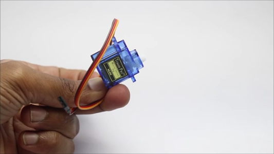

Micro servo

VCC or the red wire is connect to 5V and the Ground is for GND
Signal pin of the servo to D6

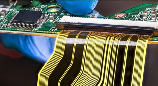

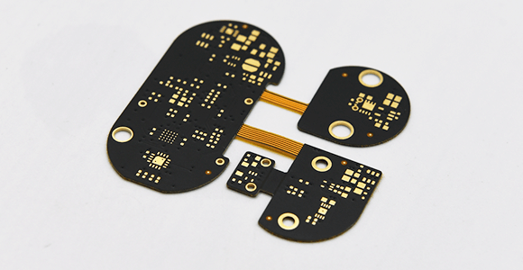

A revolutionary solution that combines the best of both rigid and flexible circuitry to elevate your electronic projects to new heights.

Their expertise in advanced manufacturing techniques offers seamless integration of rigid and flexible components, ensuring enhanced reliability, durability, and space-saving benefits.

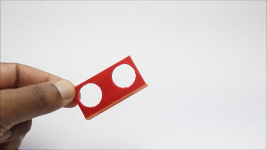

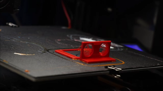

For the ultrasonic sensor casing i will design a simple object that fits the sensor and export it to cura and slice with the 30% infill with no rafts or the supports.
Later 3d print with the choice of color of your pla filament, I chose red.

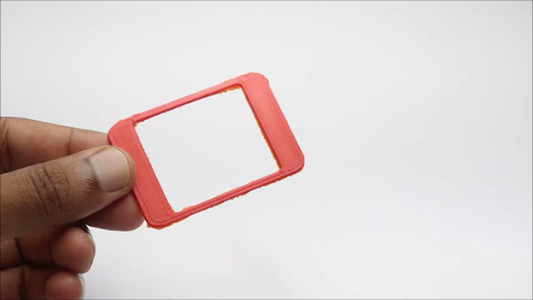

Now for the LCD display holder i simply designed a rectangular thing with a hole at the center, this will hold the LCD module safely in the base.
There was no need of using any supports at the time of print since there are no overhangs.

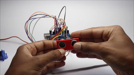

The ultrasonic sensor frame is connected to the hcsr04 first and then to the bottom of this i connected servo horns so this can be connect to servo shaft easily.
Later connect the frame to the TFT screen, This makes the screen safe from any damages.

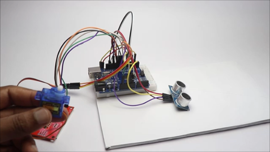

Now place all the components in the cardboard and use double sided adhesive to keep the electronics in place.
Arduino uno should be placed like i showed in these steps this is because by keeping like this if you want to make any changes to the program the board pins are easily accessible.
After you keep all the components the project is ready for testing and we can see that in the next step.
