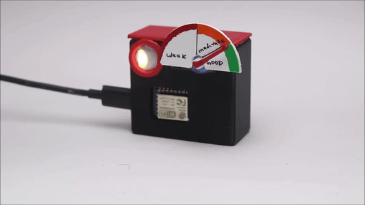

This wifi visualizer will show the speed of connected wifi device in real time and it can be your next useful desktop gadget.
It serves the 2 purpose, The first one is the it converts the digital signal into the easily readable analog signal and it can be readable by anyone.
Secondly you are seeing the unseen signals! How cool is that right.
Here i have made a meter thing that fluctuates based on your current wifi speed, you can also verify this with a web server that comes along with this project.
I have segregated the speed of wifi into 3 different types.
Green - Fast wifi speed
Orange - moderate speed
Red - Poor speed
Since most of them use 200mbps or higher wifi, you can expect the wifi meter to show orange and green levels only.

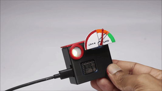

Now the base part is ready, add the meter part that is the white semicircle that we made earlier.
Note that this part is glued to the servo body and not on the servo horns, Note this when you are connecting this part.

I then added a drop of super glue and fixed the dial in the servo horn, depending on the initial position of yours you can either keep it left/right pointed.
Now mark the meter reading on the white semicircular part, i painted it with colors and also marked words for easy readability.

Using this device is very much exciting because we can finally see the results of our build.
To use this project all you have to do is power the device with usb power supply and the servo resets for its default position and in few seconds you can see the wemos board connecting the wifi(earlier given credentials)
Now on your phone/wifi connected device check for the ip address of your wemos board.
Copy and paste this IP address on any browser, and you will see a web server showing the same results as in analog meter
Now you will see the led light glowing in either red/orange/green along with the servo movements.
If the wifi strength is good the color of led wil be green and the meter will be in green zone(this indicates the excellent strength) and if the speed is moderate the led will be orange and the meter will be in middle.
The red color you can expect very rare if your wifi is deactivated or too many devices are streaming at once, I was able to get this when i was streaming in almost 4 devices and my 100mbps wifi was barely able to maintain the speed.
