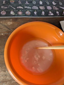

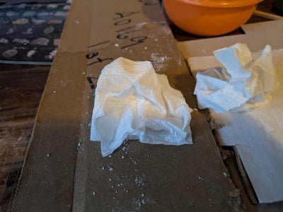

I first added a little bit of baking soda. The one I was using was a bit old, so it was a bit clumpy. Then add a little bit of water, and stir.
Step 2: Dip Your Paper Towel

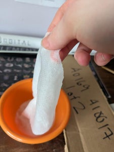

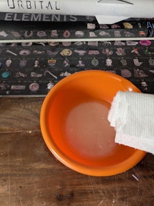

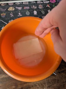

Now you want to grab your paper towel. I folded mine in half so it would fit. Dip it in, and then bring it back out, unfolding it.
Step 3: Let It Dry

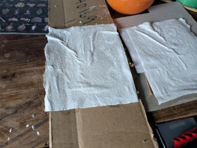

Now that you have it all dried, you want to lay it out to dry. I put mine on a piece of cardboard because I did not want this to get on my desk.
