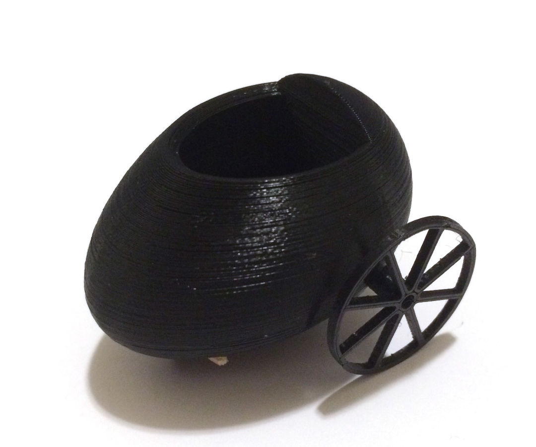

Step 1: Make a 3D Model
Make a 3d model that accurately describes how your wheel (tire and hub) will attach to your motor shaft. Pay attention to dimensions, especially motor shaft diameter and length. I recommend making a test print for the motor shaft hole diameter. Be sure to have some super glue on hand if your press fit comes loose.
I designed my wheels in Rhino for Pololu Micro Metal Gearbox motors. I have included my Rhino files for the wheels and the motor shaft hole size test. Content in this Instructable was made from the Rhino files.
