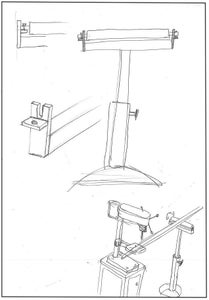

Before I started building, I drew some general sketches.
I had few ideas on how to make the device, in the end I chose the fastest and simplest way With the materials I have.

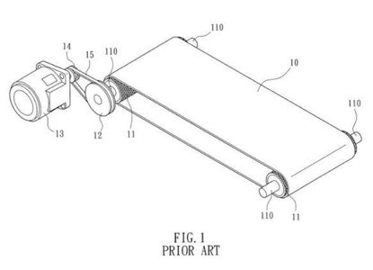

I didn't take pictures of the disassembly of the Treadmill, But usually it's like in drawings.
