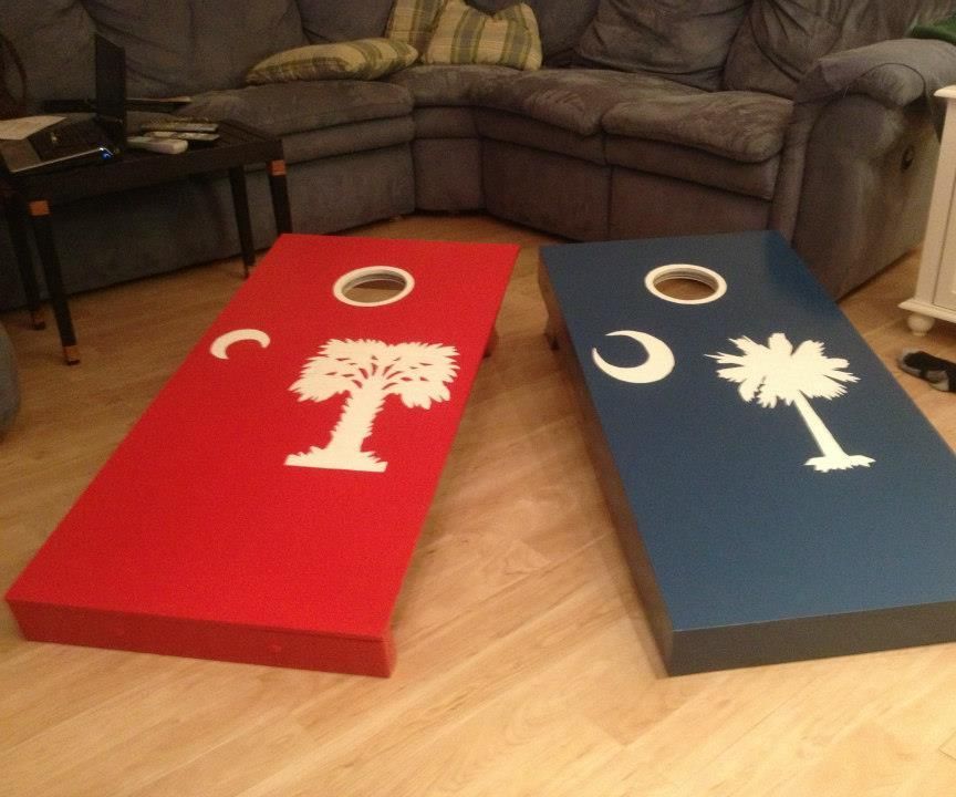

To build these boards, you will follow the Nesting cornhole boards Instructable so that both the nesting and standard boards have been constructed, but not yet puttied. Also, the chest pull will be installed in a different location.

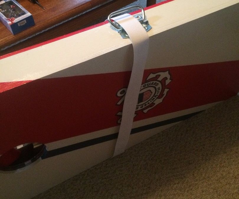

Once the boards are painted and clear-coated, you're almost done! Center and install the folding chest pull to the top of the standard board. Install the chest pull so that it will fold toward the ground during play so that it will be out of the way. You can put the spacer board, the standard board's legs, and all of the beanbags into the standard board prior to nesting. Stacking the beanbags may prevent proper nesting, which will prevent axle installation. When you get everything in the right place and place the nesting board into the standard board and achieve nesting perfection, you can now install the axle and wheels!
