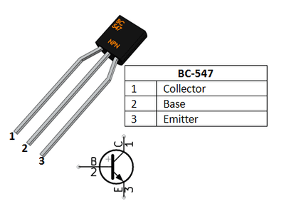

Step 2: Output of BC-547 Transistor
BC547 is an NPN Bipolar Junction Transistor. And like all other transistors BC547 has three pins. If we count it’s leg form left side then, then called the emitter, collector, and base
BC547 transistor acts as a switch between the collector and emitter. If the base of the transistor is given enough current, this switch closes and the current flows from the collector to the emitter.
So a small current to the base pin of the transistor switches the large current between the collector and the emitter.

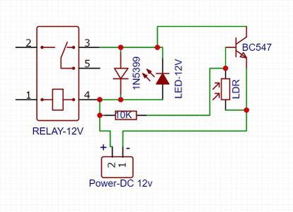

Step 5: Schematics and PCB Design
The schematics of PCBs can be seen above.

Step 7: Circuit Connection – Step 1
To make this sensitive dark sensor circuit, 1st we connect rectifier diode with the circuit. There are two coil terminal of a relay. We connect rectifier diode anode and cathode terminal with coil leg of relay.
The we connect 10 KΩ resistor with the circuit. Connect resistor one terminal with cathode leg of rectifier diode.
We utilize JLCPCB https://jlcpcb.com/RTA to printout our PCB
Step 8: Circuit Connection – Step 2
To glow light, now we need to connect DC-12v led light. Connect LED light positive leg with cathode leg of rectifier diode and LED light negative leg with anode leg of rectifier diode.
Now we need to connect transistor with the circuit. Connect BC-547 transistor “Base” leg with 10 KΩ resistor.
Step 9: Circuit Connection – Step 3
This time we connect transistor “Collector” leg with negative leg of LED light.
To control light, now we connect LDR with the circuit. We connect LDR one terminal with “Base” leg of transistor and it’s other terminal with “Emitter” leg of transistor.
Now we just need to connect power source with this sensor circuit. For power source, we are using DC – 12 volt power supply. We connect it’s negative cable with “Emitter” leg of transistor and power source positive cable with “cathode” leg of rectifier diode.

Just power On DC-12v and made dark on LDR, then you will follow that, led light is glowing and make light on LDR, the LED light will be automatically off.
