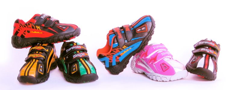

Part One describes in a rough-and-ready way how I learned to design & develop my first collection of shoes.

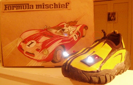

I did this by choosing shoes that I liked the overall shape of, and then using vinyl (seen here in yellow), leather & sculpey to transform the shoe into my own.
since I wanted to create a collection of racecar shoes, I spent a lot of time looking at rare sportscar magazines. The shoe pictured here is inspired by the Lamborghini Gallardo. I did another one inspired by a Bugatti which we'll come out with next season!

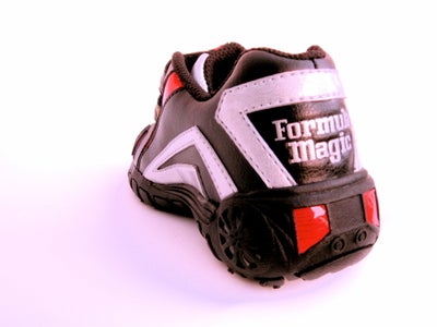

Colin, Andrew & Dan S. were very helpful in mocking up the first rounds of electronics to get my led headlights & brakelights up and running.

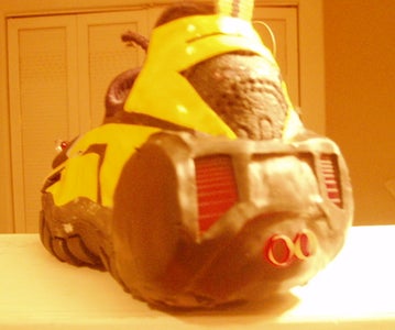

Black sculpey works great for playing with the look of your outsole. It really looks like rubber and its easy to mold.

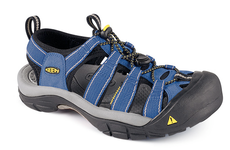

I'm sure you've seen Keen shoes. They're big and wide and comfy and funny looking. Martin Keen, who started it apparently started out with a block of wood and whittled his own last, with that crazy wide toe area.

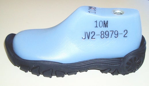

The last is the form inside the shoe that determines its shape, and is very important in making your shoe comfortable or not.
I worked with a famous old company called Jones & Vining who have been making lasts for all the big shoe companies since the 1930's. Bob Albert, who has done countless lasts with Stride Rite & other kids companies helped me develop our cute, super lasts.
Once you have a last, start Fit Testing asap; get a pullover from your factory to do this, so you are 100% sure that these shoes will be super comfortable, safe, etc.
You need your last before you can really make your outsole design, because the bottom of the last has to fit together perfectly with the shape of the outsole.
