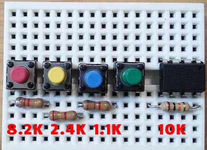

Step 3: ATtiny13a Put on the Mini Bread Board.
Please note the orientation of the ATtiny13a.
Step 4: Buttons
Please note the orientation of the button .
Step 5: Resistor
It does not work and choose a different resistance .
Please choose the correct resistance . Or modify the sketch .
