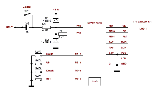

The device is extremely simple to make and contains only a few components
   - STM32F103C8T6 Microcontroller
   - 3.2 or 2.8 inch TFT color display with a resolution of 240 by 320 points powered by the ILI9341 chip
  - two diodes
  - two resistors
  - and five buttons
 The maximum input positive voltage is 6.6 V and can be increased by using an external voltage divider. If the device is made according to the given schematic diagram and code, it works immediately after the first power-on without any previous setting in the code or libraries.

 As you can see in the video, the colors of the curve can be changed very easily in the code in line:
 tft.drawLine(i*mn, 230-data1[i+i2],i*mn+mn-1, 230-data1[i+1+i2], ILI9341_RED);i++;}i=0;
