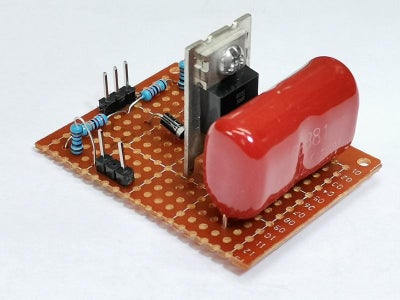

- Thyristor of the BT151 type or similar
- and few resistors
I also put an automatic fuse is placed at the input of the circuit, which should turn off the power in the event of a circuit error or burnout of any of the components.
Step 3: Principle of Operation
Let's explain the principle of operation. At the beginning, at the input of the circuit we have a switch and a circuit breaker. Then comes a series-connected MKP capacitor in this case with a value of 4µF. This capacitor limits the current in the circuit and if we double its value, the current will also double, but in this practical case its value should not exceed 8µF. For the sake of safety during long-term uninterrupted operation, I chose this lower value. Then comes a diode bridge- rectifier whose output is connected to a capacitor of 8µF. Next is the Triggering Stage for BT151Thyristor. A voltage divider using 220k + 220k in parallel with a 500k potentiometer is used to control the gate of the thyristor. A 10k resistor goes to each side of the SCR gate from the voltage divider output, along with a 10nF capacitor and diode protection. And the flyback (HV Trafo) is driven through 10 turns on the primary.
With the potentiometer, we bring a certain gate current to turn on, and at that moment the thyristor conducts and discharges the capacitor through the primary winding of the flyback transformer. Then there is a pause until the capacitor is recharged, and this process repeats.In this circuit configuration, changing the potentiometer setting changes the thyristor's firing threshold relative to the capacitor voltage. When the thyristor fires at a lower capacitor voltage, the firing frequency increases, but the output voltage decreases. In this way, we can roughly regulate the value of the high output voltage, which is a particularly useful option for experimentation.

Now let's see how the device works in real conditions. First, the potentiometer should be in the far left position. We turn on the device and gradually move the potentiometer until a spark appears between the electrodes at the output of the flyback transformer.
Now the frequency is the lowest, and the voltage is the highest, and the spark has the greatest length. With further movement of the potentiometer, the frequency increases, but the voltage decreases. I will repeat this with several different flyback transformers.
