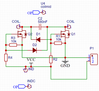

Step 3: Circuit Diagram:
Step 4: Circuit Description:
This circuit consist of 2 Mosfet named as IRFZ44N, 10k resistor between the source and gate terminals of both Mosfets. Two fast switching diodes (by399 or anyone with same capabilities like 1N4937 ).Two 390 ohms resistor from positive terminal. And a big toroidal coil & 1uf polyester film capacitor as an oscillating circuit.

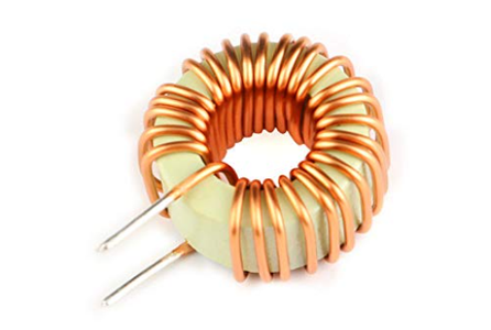

Step 6: Torroidal Coil Making:
Just take a big ferrite core and round it up in clockwise 12-13 turns. I am using here 19 SWG wire with this ferrite core and which is giving me the inductance value of 12 milli-henry. Make sure to use copper enameled wire, instead of simple wire. You can rub the ends of coil with sandpaper so that it can be soldered easily in the circuit.

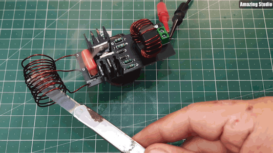

Step 7: Making of Induction Coil:
This is the same wire as used in toroidal coil, this time we are using 14 turns with a diameter of 2cm. As per rule of induction, we need two windings here. So the middle one is taken from the 7th turn of the coil.

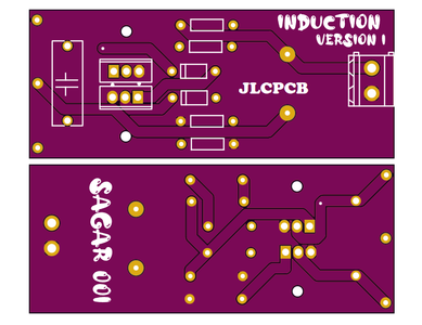

Step 8: Pcb Layouts:
Download all files, circuits and Gerbers from here.
To make this design possible JLCPCB is the only PCB manufacturer providing greatest service in $2 for 5pcs of incredible multi color PCBs. So, I designed my circuit in EasyEDA and Ordered the PCBs from JLCPCB.

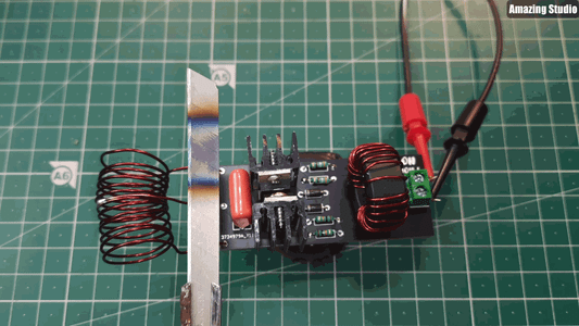

Step 11: Working:
My design is working well on 12v @8ampere and generating a high frequency AC in output of electromagnet coil. If you want to know more about the Induction circuits the here is the Wikipedia link for you.
This circuit needs a constant power supply of 8 ampere so a 12v 10amp SMPS is compulsory for that. If you are using linear power supply then use big filter capacitor and 10ampere rectifier as per demands.
