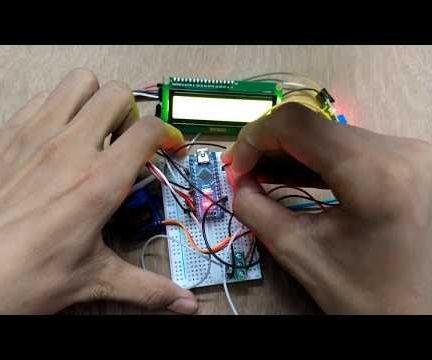

Step 2: CREATING THE BODY
First of all, we have to join arduino Uno with plastic sheet with the use of metal spacer, nuts and screws.
After that we have to attach l293d motor driver shield on the arduino UNO.
Now we have to paste both the BO motors using hot glue gun (as shown in the image).
Next procedure is to add ultrasonic sensor to arduino Uno (circuit diagram is given below in step 3).
Till here, we have almost completed our robot. We just need to add battery and both the wheels. Also we need to add a small front wheel to maintain the balance of robot..
NOTE:Join the wire according to the circuit diagram given then the step 3. If your robot getting unbalanced OR making a backflip while moving, then add a small tail.
Here your robot is ready to enjoy.

Step 4: FINAL VIEW
Our robot is ready but it may have some fault.
In my case the robot was not properly balanced that's why i have added a tail as support.
You can also decrease the speed of motor or by providing less voltage.
So, i hope you won't face any errors or problem in this project.
