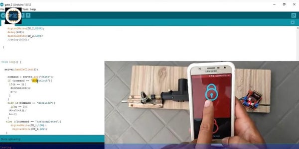

Step 1: Connect Node Mcu to Computer and Open Arduino ID Software
Set lock and lock button password by pressing long Buttons
Step 2: Select Board and Port and Upload Code
Code and Android App:- https://drive.google.com/drive/folders/1KO8V1DuUwK6dZ52U82fQCYxx8jH2swVq?usp=sharing
