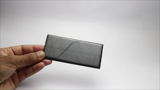

The solar lamp that i built is made from recycled electronics and a plastic jar that was upcycled from candy jar
Solar panel was from old lamp and the LED panel was also a recyled part, by consolidsting all of them i made something useful that will be useful in many ways

Solar Panel (5v, 200ma)

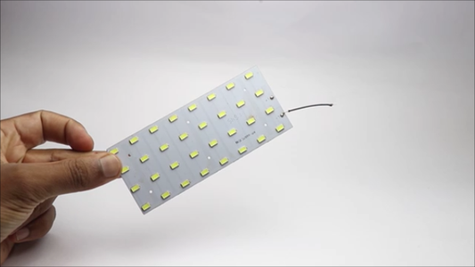

LED panel

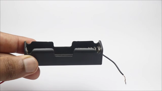

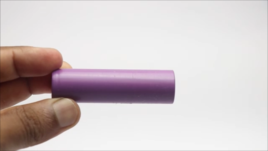

Lithium ion battery with holder

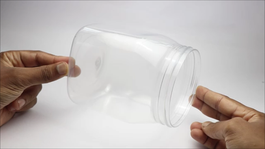

Plastic Jar

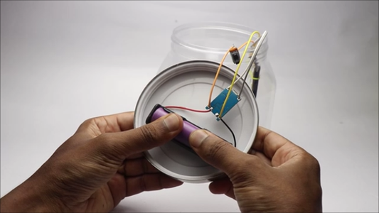

Step 1: Circuitary

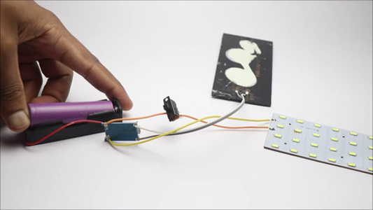

The circuit connection is simple if you are already familiar to the basic electronics or a hobby builder, If you are not, don't worry i will explain the connections

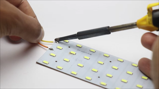

The solar panel and the LED panel was soldered first with jumper cables

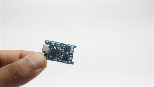

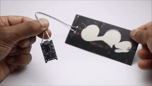

Solar panel was connected to the output side of TP4056 and to control the panel i added an on and off switch between the connections
Next the power source to charge the battery is the solar panel that is connected to power input side of the charging board, Solder these components well to the board
In the end solder the battery to the charging board, I will use the battery case to hold the batteries that will help to easily remove and insert the batteries whenever needed
If needed you can also insulate the joints, But it is not necessary since we are csaing all the electronics inside a jar that is water proof
The choice of solar panel is left to you, But i strongly recommend to use rectangular ones like the one that i used since they were a perfect fit inside a jar and also the size of a LED panel

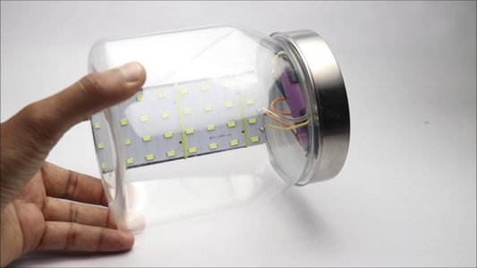

Step 2: Final Assembly

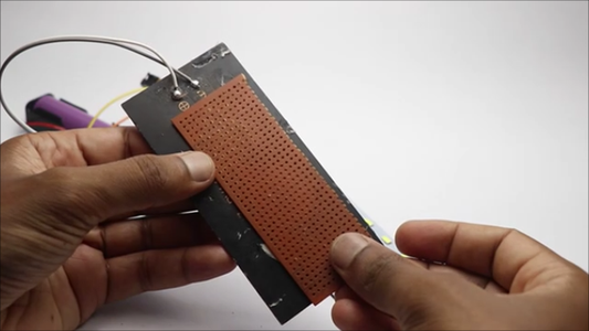

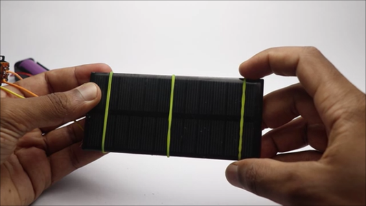

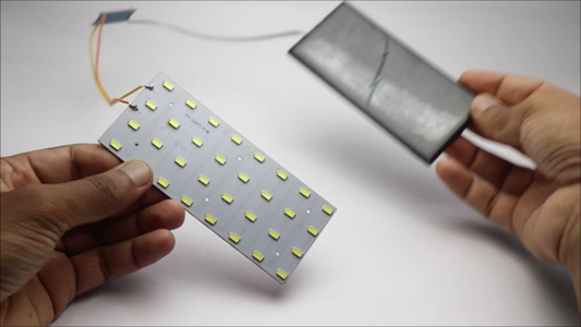

The main reason for uisng LED panels is because they wont heat at all and if they do it is very negligible, so to the backside of this i will add the solar panel
In the other way round when we are exposing solar panel to the sunlight it will heat up the led panel if it is attached directly without any insulators

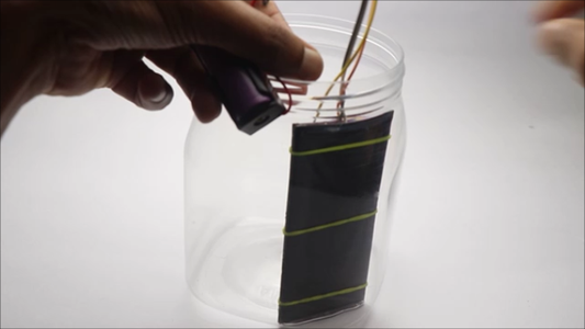

I didnt want this to happen so i will use a smal piece of PCB that is sandwiched between these 2 layers

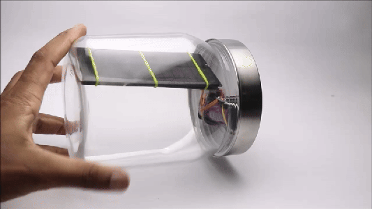

I recommend not to use any glue here, i coupled all this components using a elastic band, One is not enough you will need 3 of them altogether and you can see how i placed them

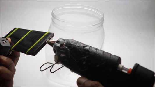

After this is complete you can add hot glue to the bse of these panels and attach to the base of the jar as shown in the steps above make sure the glue is not too hot or not too less hot
It will take some time to dry completely and now we can attach the battery holder to the base of the lid followed by the switch
In this point we are done with the assembly part and we are all ready to test the lamp

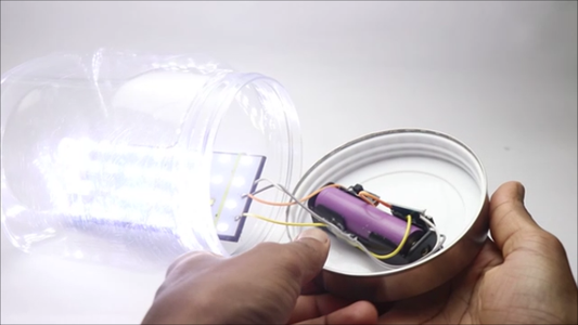

Step 3: How to Use
Using this is everyones favorite part including mine! This will show how hard we had worked to reach this stage of the project its like fruit for the effort

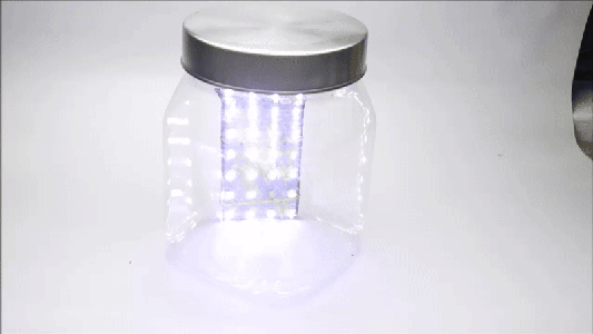

To use this solar panel all you have to do is loose the lid and have access to the on/off switch

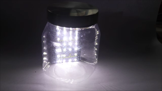

Turn on the switch and now you have LED light panel glowing and later close the lid, Now you can place it in rain also no matter what the water will not enter inside and the light keeps on glowing
When you want the led to be off all you have to do is loose the lid and tuen off the switch inside
Now if you want to charge this lamp, Simply keep the light to sunlight exposed areas and in some time the battery will be charged

I recommned to use plastic jar to build this lamp because we are giving the jars a second life which on the other hand will be dumped as a waste and it will later cause some sort of pollution to the environment
