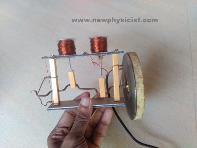

Introduction: How to Make Solenoid Engine DIY
let’s make a solenoid engine. You may have seen many videos of making solenoid engine online. There are hundreds of such videos on youtube. But this project is entirely different. We designed it in a way how automobile engines work. You can see many components similar to those in an internal combustion engine.
Read full DIY Guide Solenoid Engine
More DIY Projects Like this New Physicist
Step 1:
Step 1: Making of Solenoid Cylinder
First of all Cut two Similar Pieces of ACP or fibre sheet.
And mark Syringe dia on the sheet.
Then Remove unwanted Part.Now cut 2” length from a cylinder part of a syringe.
Fix the Syringe piece on the sheet.
Now is the time to wind the 26 gauge copper wire on the syringe piece.
Wind magnet wire tightly. Minimum turns 60, maximum: as much as possible.
The more you wind magnet wire, your engine will perform faster and powerful.
Make necessary holes. Watch Video.
