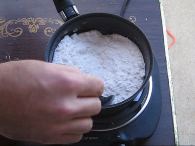

Step 2: Mix Ingredients
Mix it at 60% potassium nitrate and 40% sugar by weight. Easy.

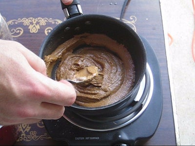

Step 3: Slowly Add Heat
Slowly add heat and continually stir. After a few minutes the sugar will begin to melt and get soupy.
Don't burn it!!!! This is why you do this outside. If it lights, the whole thing is going up in flames. Wear safety protection. Geez.
Once it gets soupy, as in the last photo, it is ready to pour.

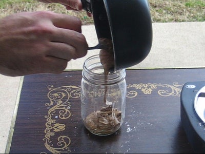

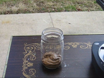

Step 4: Pour Into the Mold
In this case I simply poured it into a glass container (which isn't a good idea as it turns out as you'll see in the final video.)
At this point you would pour the solution into whatever mold you'd like. Have it ready to go, the solution will harden quickly.
Add any wicks before it hardens.

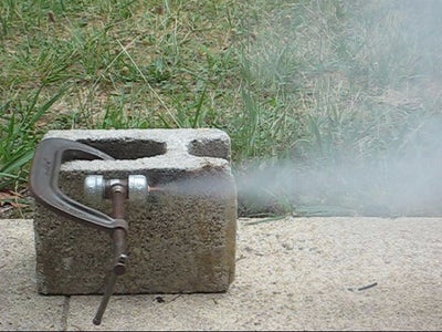

I also made a small solid rocket motor which you'll see in the final video.

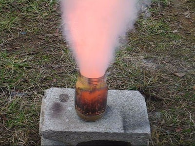

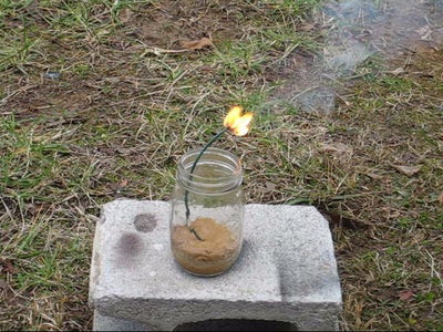

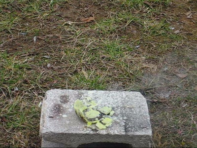

Step 5: Light It Up.
Light the fuse and get back. The glass will explode from the sudden temperature change, that is why I recommend not doing that. Check out the video.
