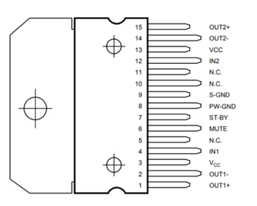

Step 3: Sound IC Pin Out
1.    OUT 1 +
2.    Out 1 –
3.    Vcc
4.    IN 1
5.    N-C
6.    Mute
7.    Stand-By
8.    Pw-Gnd
9.    S-Ground
10.  N.c
11.  N.C
12.  In 2
13.  Vcc
14. Out 2 –
15. Out 2 +

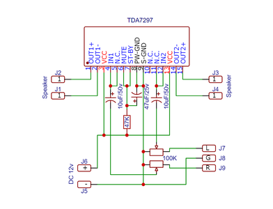

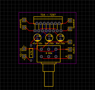

Step 4: Schematics and PCB Design
The schematics of PCBs can be seen above.
Step 5: Circuit Connection – Step 1
To make this amplifier circuit, 1st we connect 4no and 5no leg of sound IC, 6no and 7no leg of sound IC, 8no and 9no leg of sound IC, 11no and 12no leg of sound IC. Then we need to connect sound IC 3no and 13no leg.
Step 6: Circuit Connection – Step 2
Now we need to connect resistor with the circuit. We are using 47 KΩ resistors to make this stereo amplifier circuit. Connect this resistor one terminal with 6no leg of Sound IC and its other terminal with 3no leg of Sound IC.
Then we need to connect 3 capacitors with the circuit. Connect 47µf/25 volt capacitor negative leg with 8no leg of sound IC and capacitor positive leg with 7no leg of sound IC.
Thanks to JLCPCB for offering us, this PCB circuit.
Step 7: Circuit Connection – Step 3
There are two rest capacitors. Connect 10µf/50 volt capacitor positive leg with 11no leg of Sound IC and its negative leg with Output leg of stereo volume.
Now we connect another 10µf/50 volt capacitor positive leg with 4no leg of Sound IC and its negative terminal with Output leg of stereo volume.
Step 8: Circuit Connection – Step 4
To adjust sound, we are using B-100k stereo volume. We connect volume ground leg with 9no leg of sound IC.
To input sound, now we connect audio input cable with the circuit. Connect audio input “L” and “G” and “R” cable with input leg of stereo volume.
For output sound, we need to connect sound speaker with the circuit. We connect left side sound speaker with 1 and 2 number leg of sound IC and right side speaker with 14 and 15 no leg of sound IC.
 We utilize JLCPCB https://jlcpcb.com/RTA to printout our PCB.
Step 9: Circuit Connection – Step 5
For power source, we are using DC-12v power source. We need to connect sound IC 3no leg with positive leg of power source and sound IC 9no leg with negative leg of power source.
Now just plug-in power source and connect audio input cable with mobile. Play music on mobile and enjoy the high quality sound.

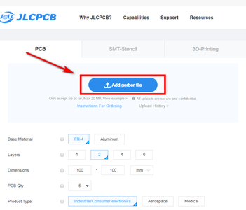

Step 10: Steps to Order PCBs From JLCPCB
If you complete design of your PCBs, then it is time to order PCBs. To order best quality PCBs, just visit JLCPCB and click on the QUOTE NOW button.
Since 2006, JLCPCB continuously driven to become more efficient and to reduce costs. They promise to offer customers the most economic PCBs forever. JLCPCB makes cheapest but top quality PCBs possibly because of scale effect, extremely high production efficiency and less manpower cost.
You can order minimum 5 pieces PCBs for only $2 costs.
To order PCBs, make your Gerber file. Then drag and drop the Gerber file on the following box.
Click on “Gerber Viewer” button you can check the PCBs design. Make sure everything is good, then choose color, quantity and order your PCBs at very reasonable prices.
If you are a new user, then you can order 10 pieces PCBs, costing only $2. To place your order click on “Save to Cart” button. Confirm your shipping address and shipping method.
