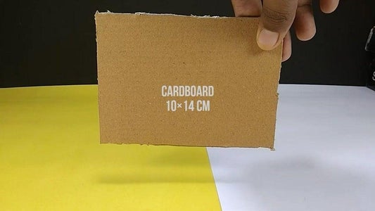

Step 2: Making of the Chassy :
~ So for making the chassis I am using cardboard which is cut into the size of 10*14 cm.

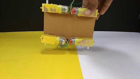

~ Then we need a gear motor 4pcs.
~ We will stick the motor with the cardboard using the hot glue gun.
~ We move into the wiring of the motors, the wiring will go in this way, we will solder the wires to the motors "+" and "-" terminals. As shown in the above image.
~ We will require a rubber wheel (4pcs) for the motor.
~ Put the rubber wheel in the gear motors. As shown in the above images.
~ Then our chassis is ready.

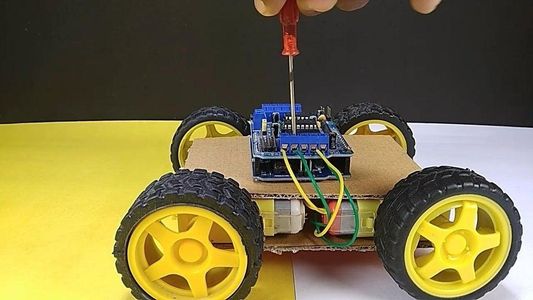

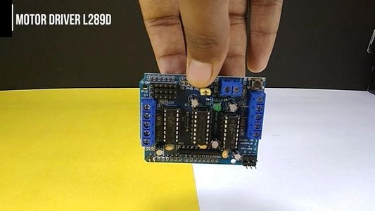

Step 3: Attach the Motor Driver With the Arduino Uno & Connecting the Motor Wires With the Motor Driver:
~ Now this step is very simple you need to attach the motor driver to Arduino Uno. Just motor driver according to the pin in the Arduino Uno.
~ So here we go, we need to put all the wires of the motor to the motor driver's Motor terminals.
Just put the first motor's wire to the motor driver M1 terminal. Then put the second motor's wire to the M2 terminal. Do the same with the rest of the motors.

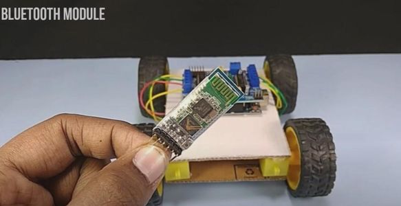

Step 4: Mounting the UltraSonic Sensor & Bluetooth Module Into the Chassis:
~ We will simply take fourjumper wires for Ultrasonic Sensor and four jumper wires for Bluetooth Module.
~ Attach it to the Ultrasonic sensor's pins:
+5v, GND, Trigg, Echo.
~ Attach it to the Bluetooth Module's pins:
+5v, GND, Tx, Rx.
~ Then we will fix the Ultrasonic sensor & Bluetooth Module to the Chassis with the help of Double-Sided Tap.

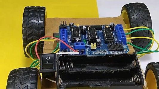

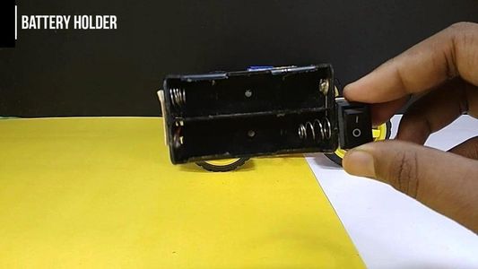

~ We will that a Battery Holder and fix it to the chassis using Double Sided Tap.
Then Connect the GND wire of Holder to the Motor driver's Power GND Terminal. Then Connect the +5V wire to the Vcc or +5V Terminal of Motor driver.
