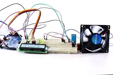

Step 1: Electronics Connection
Connect all the electronics as shown in the figure

Step 4: Upload Code
Connect the Arduino Board with the Arduino IDE and upload the given CODE
#include <DHT.h>
#include <Wire.h>
#include <LiquidCrystal_I2C.h>
#define DHTPIN 2
#define DHTTYPE DHT11
DHT dht(DHTPIN, DHTTYPE);
const int potPin = A0;
const int fanPin = 3; // Connect the fan to this pin
LiquidCrystal_I2C lcd(0x27, 16, 2); // Set the LCD address and dimensions
void setup() {
dht.begin();
pinMode(fanPin, OUTPUT);
lcd.init(); // Initialize the LCD
lcd.backlight(); // Turn on the backlight
lcd.setCursor(0, 0);
lcd.print("Temp Fan Control");
lcd.setCursor(0, 1);
lcd.print("by Your Name");
delay(2000);
lcd.clear();
void loop() {
int threshold = map(analogRead(potPin), 0, 1023, 20, 40); // Map potentiometer value to temperature range
float temperature = dht.readTemperature();
if (temperature > threshold) {
digitalWrite(fanPin, HIGH); // Turn on the fan
} else {
digitalWrite(fanPin, LOW); // Turn off the fan
lcd.clear();
lcd.print("Temp: ");
lcd.print(temperature);
lcd.print("C");
lcd.print("Threshold: ");
lcd.print(threshold);
lcd.print("C");
delay(1000);
