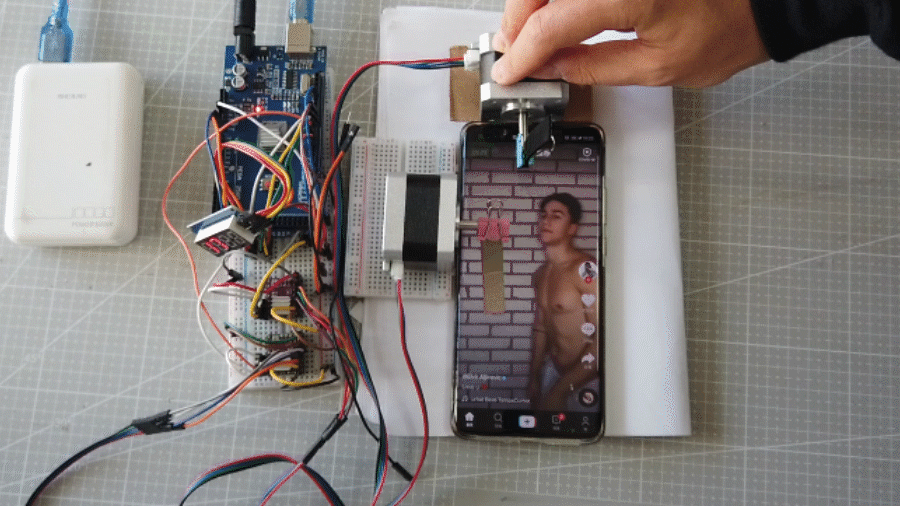

Introduction: How to Make Tiktok Scroll Automatically Physically and Follow Everyone Using Arduino and Step Motor
Today, we will make a device which will auto Tiktok scroll Physically, it is not a app. The X-axis is set to slide up and down, and the Y-axis is set to slide left and right, and one more servo is set to follow everyone. Have fun with it.
► Code in GitHub (scheme and sketch): https://github.com/DKARDU/titokscroll
► Components The following parts were used in this project:
Arduino MEGA 2560
2 x 42 stepper motors, https://amzn.to/3nBxvs2
2 x drv8825 stepper motor driver modules, https://amzn.to/3nBxvs2
TM1637 4-digit digital tube, https://amzn.to/3nBxvs2
MG90S servo, https://amzn.to/3nBxvs2
9V battery 100uf capacitance, https://amzn.to/3nBxvs2
Mini capacitive resistive touch screen pen
Capacitor silicone conductive brush head
