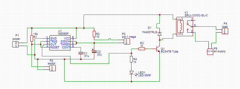

Step 2: Design & Order the Pcb

Gerber file-https://drive.google.com/file/d/1U0z5TdqXhhFlvfgz5JweIPFRe6kwi13j/view?usp=sharing
Circuit diagram-https://drive.google.com/file/d/1Ux-_oeBptZCb-r0qmfhtDXNH4yfL6R4g/view?usp=sharing

To make this circuit the following components are required....
1.IC 555
2.Bc 547 transistor
3.8 pin ic base (optional)
4.103 pf
5.12v spdt relay
6.12v power supply
7.1k resistor*3
8.15k resistor
9.1n4007 diode
10.led (any colour)
11.power cable to supply the 220v...
12.1 megaohms potentiometer
13. 33uf capacitor,25v or 16v

Step 4: Assemble the Circuit
Now connect all the components to the pcb & solder it carefully......
Step 5: Connect the Power Supply & the 220v Load
Now connect all the external supply like 12v power supply & the 220v supply ...to the circuit
Step 6: Calculate the Time
To calculate the time download the timer app to your smartphone....
Procedure....
1. open the 555 timer app...
2.click on monostable mode
3.Choose the resistor & the capacitor according to your required time....
App link-https://play.google.com/store/apps/details?id=com.peterhohsy.timer555calculator
Step 7: Now You Are Done...
Now your circuit is ready to use....
you can use it to any electrical appliances like fan,tv,mobile charger etc....
also you can modify the time by using the 555 calculator....
