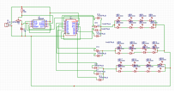

Step 2: Design & Order the Pcb
In this project I make the pcb using easyeda tool & order the pcb on jlcpcb.com..... They provide high quality pcb at very cheap prices..... I order the blue colour pcb.....They provide 10 green colour of pcb under $2 at first order..... This is the cheapest deal anyone can get.... To order the pcb....

Gerber file-https://drive.google.com/file/d/1pkRD_-j4UNeGhKSLEJmDwHUDaGyqmHzX/view?usp=sharing
Circuit diagram-https://drive.google.com/file/d/1_58IwjTve3-FRXILdRZ7wlo1WCzXeK81/view?usp=sharing

To make this circuit the following components are required....
1. IC 555
2. Ic 4017
3. Green Led*8
4. Red Led*8
5. Yellow Led*8
6. 1n4007 diode*9
7. 16 pin ic base (optional)
8. 8 pin ic base (optional)
9. 100k resistor
10. 100k or 1 megaohm preset
11. 10uf capacitorm, 16v or 25v
12. 9v battery with battery cap
