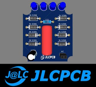

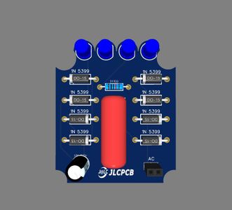

Step 2: LED Driver Circuit Design
The schematic of this transformer less LED drive circuit along with the PCB layout can be seen above. We make a series connection with the 4 pieces 5mm led light. You also can use DC 12v led light or motor to test the circuit.
Step 3: Connect LED With PCB
To make this circuit, 1st we connect 5mm LED light with the circuit. That means we connect one LED negative leg with another LED positive leg. We follow same process for 4 LEDs. Finally we will get 2 different terminal. One is negative and other one is positive.
Step 4: Connect Diode With PCB
We are using 8 pieces diode to make this circuit. Diode model is – 1N 4017. Simply we divide in 2 side, then we get 4 diode in each side. Using this 4 diode we make a bridge connection for both side. Then we make a parallel connection between this two bridge circuit.
Step 5: Connect Resistor With PCB
For making this circuit, we are using 10 KΩ resistor. Now we connect this resistor with bridge diode circuit. Connect this resistor with diode positive and negative leg.
Step 6: Connect Capacitor With PCB
Now we connect 100µf/25v capacitor with the circuit. As we connect resistor, in the same process we connect capacitor with the circuit. We connect capacitor negative leg with Diode positive leg and connect capacitor positive leg with diode negative leg.
Step 7: Connect Polyester Film Capacitor With PCB
In this process, we need to connect polyester film capacitor with the circuit. To make this circuit, we use 105J-400v capacitor. We connect this capacitor one terminal with AC line and another terminal with bridge circuit AC line.
Step 8: Last Step for Circuit Connection
To glow LED light we need to connect LED light with the circuit. We connect LED negative leg with capacitor negative leg and connect LED positive leg with capacitor positive leg.
Finally we connect, AC line cable one terminal with empty leg of polyester film capacitor and Ac line another terminal with other bridge diode circuit.
Step 9: Soldering and Cleaning
Neat and perfect soldering play an important role for all kind of PCBs. Since soldering, you should remember that, there should not be any kind of short circuit connection. After soldering all leg, we cut-off the extra leg of all electronics component. For better result you can use liquid PCB cleaner.
Step 10: Final Action
Our circuit, is now completely ready for use. Now just plug-in power with AC line voltage and enjoy the circuit.
