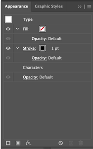

Step 3: Add New Stroke
Select your text and go to Window > Appearance. Click on the top right hand menu in the Appearance window and click 'Add New Stroke".
Step 4: Change the Layer Order
In the Appearance window, drag the Fill layer above the Stoke layer. This is an important step because you want the "shadowed" colors behind the original text.

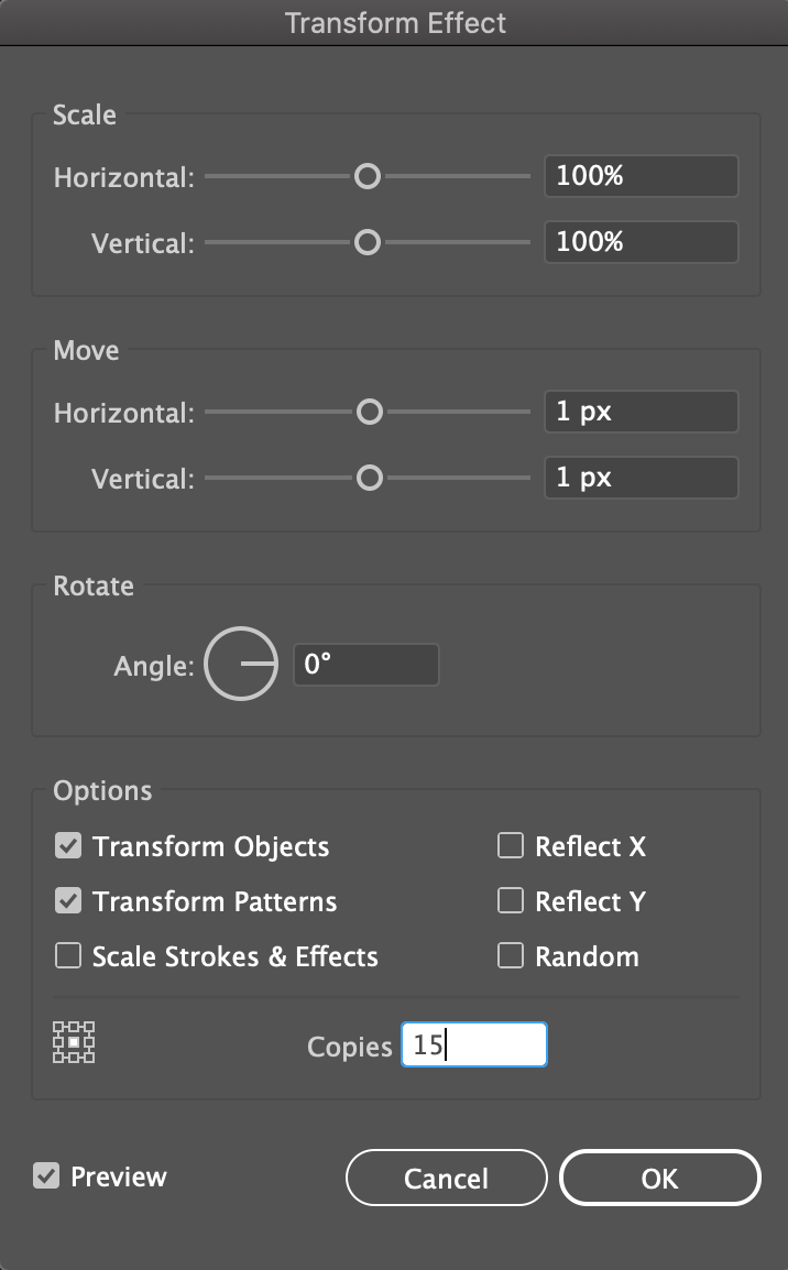

Step 8: Transform Stroke
In the Transform effect menu, move the Horizontal and Vertical sliders to 1px and change the copies to 15. You should see the stroke behind your text move lower and to the right.
