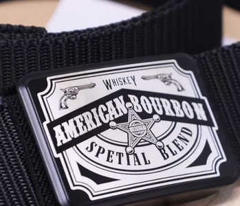

Step 6: Complete the Laser Marking
Once laser marking is complete, carefully open the door and get your personalized coated alloy belt buckle. Laser marking does not produce toxic substances, and you can wear it after a simple cleaning!
laser marking western style belt buckle done
