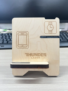

White maple wood cell phone watch holder is a stylish and durable. Ideal for hands-free use, it features a smooth finish, stable base, and eco-friendly construction, blending functionality with natural elegance.
Now is going to use a Thunder Laser system to make laser White maple wood cell phone watch holder. Let’s start to explore fun with the laser!

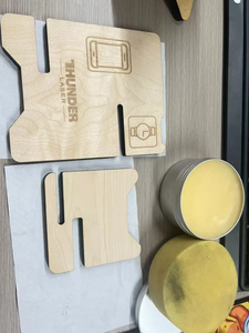

Step 2: Make It

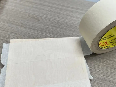

Place White Maple on the laser bed. You can use auto and manual focus. Paint tape on the back of the white maple to reduce reflections. Press “Origin” on the LCD control panel to set the starting position, then press “Start” to begin working.
We can use a polisher or sandpaper to polish the White maple wood cell phone watch holder for removeing greasy and dirty. And then wax it. Let's do it by yourself!
