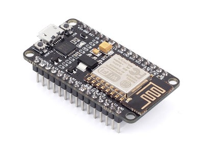

Step 1: Required Hardware and Software

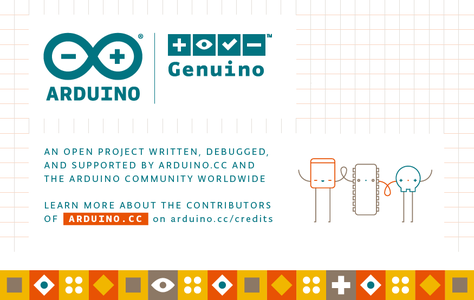

Step 2: Setting Up
- Download and install arduino ide from arduino website Link: https://www.arduino.cc/en/main/software
- After installation open arduino and Go to File > Preferences
- In additional Board manager tab copy this address and then click ok http://arduino.esp8266.com/stable/package_esp8266...
- Now go to Tools > Board > Boards manager
Wait for the processing. Then type ESP8266 in search bar, select version and install version 2.0. Install only 2.0 because on other versions it won't work

Now Select your ESP8266 board at Tools > Board and select the port at which Node-Mcu connected at Tools > Port.

- Power up the Node-Mcu with laptop power or power bank or any other charger cable
