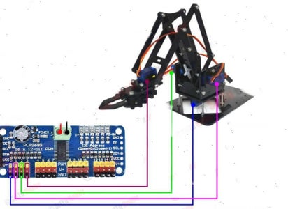

Step 2: Servo Motors & PWM Servo Motor Driver Wiring:
Refer to the attached image and connect all four servo motor wires to the PWM servo motor driver pins.
Component | PWM Servo Pin |
Figure Servo | 0 |
Right side Servo | 1 |
Left side Servo | 2 |
Base Servo | 3 |

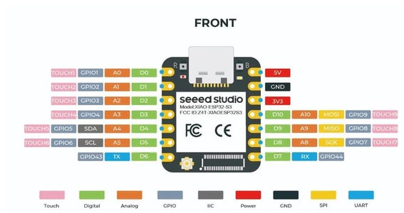

Step 4: XIAO ESP32S3 & PWM Servo Motor Driver Wiring:
The Seeed Studio XIAO Series is a tiny development board with a thumb-sized size and a comparable hardware design.
Check out the well-written wiki provided by Seeed Studio at the link below to learn more about how to use this device.
https://wiki.seeedstudio.com/xiao_esp32s3_getting_started
Refer to the attached image and connect XIAO ESP32S3 to the PWM servo motor driver pins.
XIAO ESP32S3 Pin PWM Servo Motor Driver Pin
- XIAO ESP32S3 D5 PIN PWM servo motor driver SCL PIN
- XIAO ESP32S3 D4 PIN PWM servo motor driver SDA PIN
- XIAO ESP32S3 GND PIN PWM servo motor driver GND PIN
- XIAO ESP32S3 5V PIN PWM servo motor driver VCC PIN
