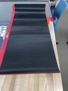

  2. Selection of Twill Colors: Select two contrasting colors of felt or twill to achieve a layered look. For this project, red and black twill were chosen to make the design elements pop.
  3. Measuring and Cutting: Measure your felt or twill to ensure it fits the laser cutter’s bed. The finished logo should be approximately 4.75 inches in size. Proper preparation ensures smooth execution during the cutting process.

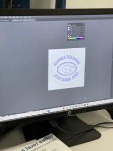

  1. Uploading the Design: Save your Canva design as an SVG file and upload it to Adobe Illustrator. Use the tracing tool to outline the design, converting it into a format suitable for laser cutting. This step ensures that every line and curve is accurate and avoids errors during the cutting process.

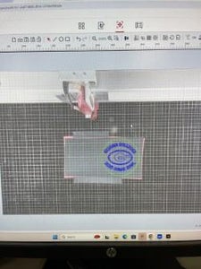

  2. Importing to Ruby Software: Import the traced design into the Trotec Laser Ruby software. This software is specifically designed to optimize cutting paths and ensure efficiency. Adjust the settings for cutting twill or felt, ensuring the laser’s power and speed are set appropriately to avoid burning or incomplete cuts.
  3. Preparing the Material: Carefully align the felt or twill on the laser cutter bed. Tape down the edges securely to prevent any movement during the cutting process. Proper alignment ensures that the cuts are precise and consistent.
  4. Laser Cutting: Begin the laser cutting process by starting the machine. Once the cutting is complete, carefully remove the material from the cutter. Peel back the first layer of twill to reveal the intricate design. For this project, the red background highlights the black text and logo, creating a striking visual effect.

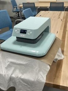

  1. Setting the Temperature: Preheat the heat press to 315°F. This temperature is ideal for adhering twill to fabric without causing damage. Ensure the heat press surface is clean and free of debris to avoid imperfections on the t-shirt.
  2. Positioning the Logo: Lay the t-shirt flat on the heat press plate. Position the laser-cut logo on the shirt, ensuring it is centered and aligned properly. Use a ruler or a guide to confirm the placement is straight and proportional.
  3. Protective Layer: Place a protective sheet, such as Teflon or parchment paper, over the twill. This prevents the material from melting or sticking to the heat press plate. It also helps distribute heat evenly across the design.
Step 4: Heat Pressing the Design
This step fuses the twill design to the t-shirt and requires precision:
  1. Pressing: Close the heat press and apply even pressure for about 18 seconds. The combination of heat and pressure ensures the twill adheres securely to the shirt. Monitor the timer closely to prevent over-pressing, which could damage the design.
  2. Cooling: Remove the shirt from the heat press carefully. Allow it to cool for approximately 20 seconds before handling further. Cooling helps the adhesive set properly and ensures durability.

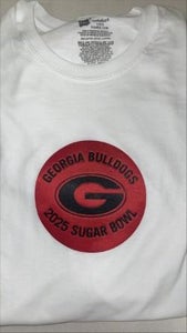

  1. Inspection: Examine the edges of the twill design closely. Ensure all parts are fully adhered to the fabric. If any edges are loose, reapply the heat press for a few seconds with the protective layer still in place.
  2. Clean-Up: Remove any stray threads, adhesive residue, or lint from the t-shirt. This step gives the final product a polished and professional appearance.

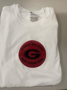

  3. Admire Your Work: Lay the t-shirt flat and admire the completed design. The layered red and black twill logo, featuring the UGA branding and "Georgia Bulldogs" text, stands out vividly against the fabric. It’s a testament to your creativity and technical skills.
