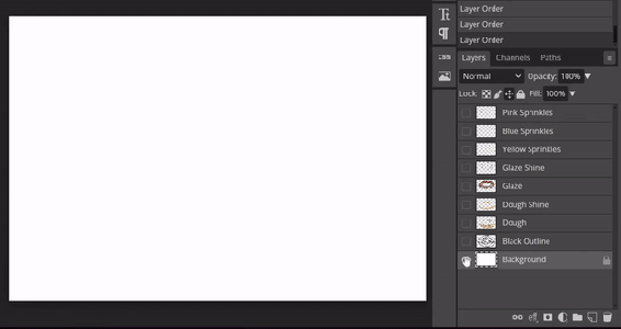

Step 6: Isolate the Other Colors
Once you are familiar with the process, go ahead and isolate the rest of the colors. As you go, make sure to name each layer according to what parts of the image they represent and what color, for instance, "Pink Sprinkles". This makes it easier to work with the files once we export them and ensures that they don't get mixed up during the 3D modeling process.
