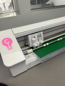

- Vinyl Cutter: This is the most important tool. Popular options include the Silhouette Cameo, Cricut Maker, and Brother ScanNCut. When I went through the process, I chose to use Silhouette Studio as it makes it easy to paste images from the internet into the worksite or use their own drawing features!

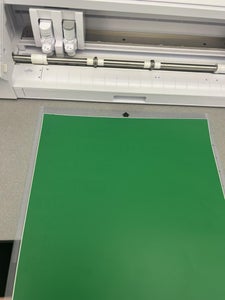

- Cutting Mat (if necessary): Some vinyl cutters require a cutting mat to hold the vinyl in place. The mat will help hold the vinyl in place and show you where exactly to place the vinyl sheet.

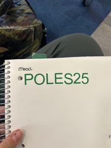

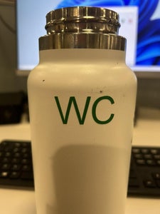

- Choose a Theme: Decide on the theme or message for your sticker. This could be anything from a quote, a logo, or a fun graphic. For the stickers I created, I wanted to give the people in Greek Life on campus fun stickers to put on their water bottles and notebooks!

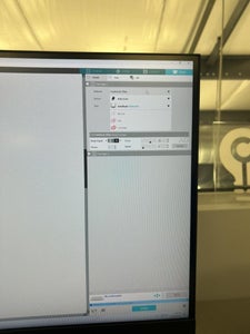

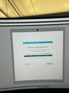

- Open Your Design Software: Launch the software associated with your vinyl cutter. If you’re using a program like Adobe Illustrator, create a new document. I used Silhouette Studio and created a new design sheet to work with.

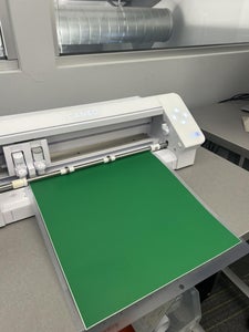

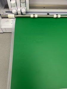

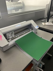

- Load the Vinyl: If your cutter uses a cutting mat, place the vinyl sheet on it, ensuring it is adhered well. If it’s a roll-type cutter, load the vinyl according to the machine’s guidelines.
- Set the Blade Depth: Adjust the blade depth based on the type of vinyl you are using. Most machines have settings for different materials; consult the user manual for specifics.
- Test Cut: Before cutting your actual design, perform a test cut on a small piece of vinyl. This helps ensure that the settings are correct and that the blade isn’t cutting too deep or too shallow.

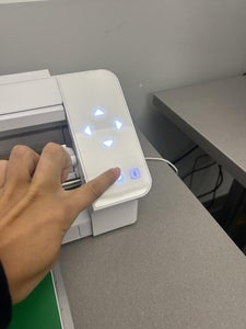

- Send the Design to the Cutter: In your design software, select the option to send the design to your vinyl cutter. Ensure that the correct material type is selected in the settings.
- Monitor the Cutting Process: Keep an eye on the cutter as it works. If you notice any issues, such as the blade snagging or not cutting properly, pause the machine and troubleshoot.
- Finish Cutting: Once the cutting is complete, the machine will either stop automatically or allow you to pause and cut manually. Carefully unload the vinyl sheet from the cutter.

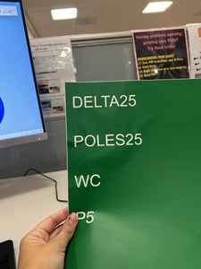

- Weeding: Use your weeding tool to carefully remove the excess vinyl around your design. Start from one corner and work your way around. Take your time to avoid damaging the sticker itself.
- Cutting Out the Sticker: If you want a specific shape around your sticker, use a craft knife and ruler to trim it accordingly.
- Transfer the Sticker: To apply your sticker, peel the backing off carefully, leaving the sticker on the transfer tape. Position it on your desired surface and press down firmly, then slowly peel away the transfer tape, leaving the sticker in place.
- Apply the Sticker: Also, if you do not have the transfer tape, that is ok! The vinyl sheet comes with its own sticker sheet on the back making it so you can cut your sticker out of the sheet and apply it yourself by simply peeling it off.
