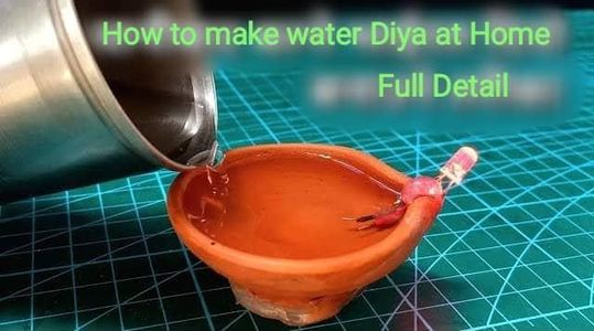

Introduction: How to Make Your Own Water Diya at Home
In this project, we will see the simplest way of making Water Diya at Home. The concept of water Diya came from oil Diya but the unique features of water Diya is, It glows while pouring water on it.

All the Circuit is made and arranged in such a way that two conducting wires seems to be separated inside Diya. Now when we pour water inside the Diyo it forms conducting path between Diyo. Then current flows through the wires and our led will glow.

Above is the circuit diagram of this project. As shown in the figure, connect the collector of your BC547 Transistor to negative terminal of your LED. Now, Take one 3 volt lithium cell and connect it positive terminal to anode terminal of LED, also connect negative terminal to emitter of the transistor. Make the positive terminal of led as probe 1 and base of the transistor as probe 2. Finally attach all the circuit to diya making two probe of the circuit inside the diya.
Now when we pour water inside the diyo. It will glow.
