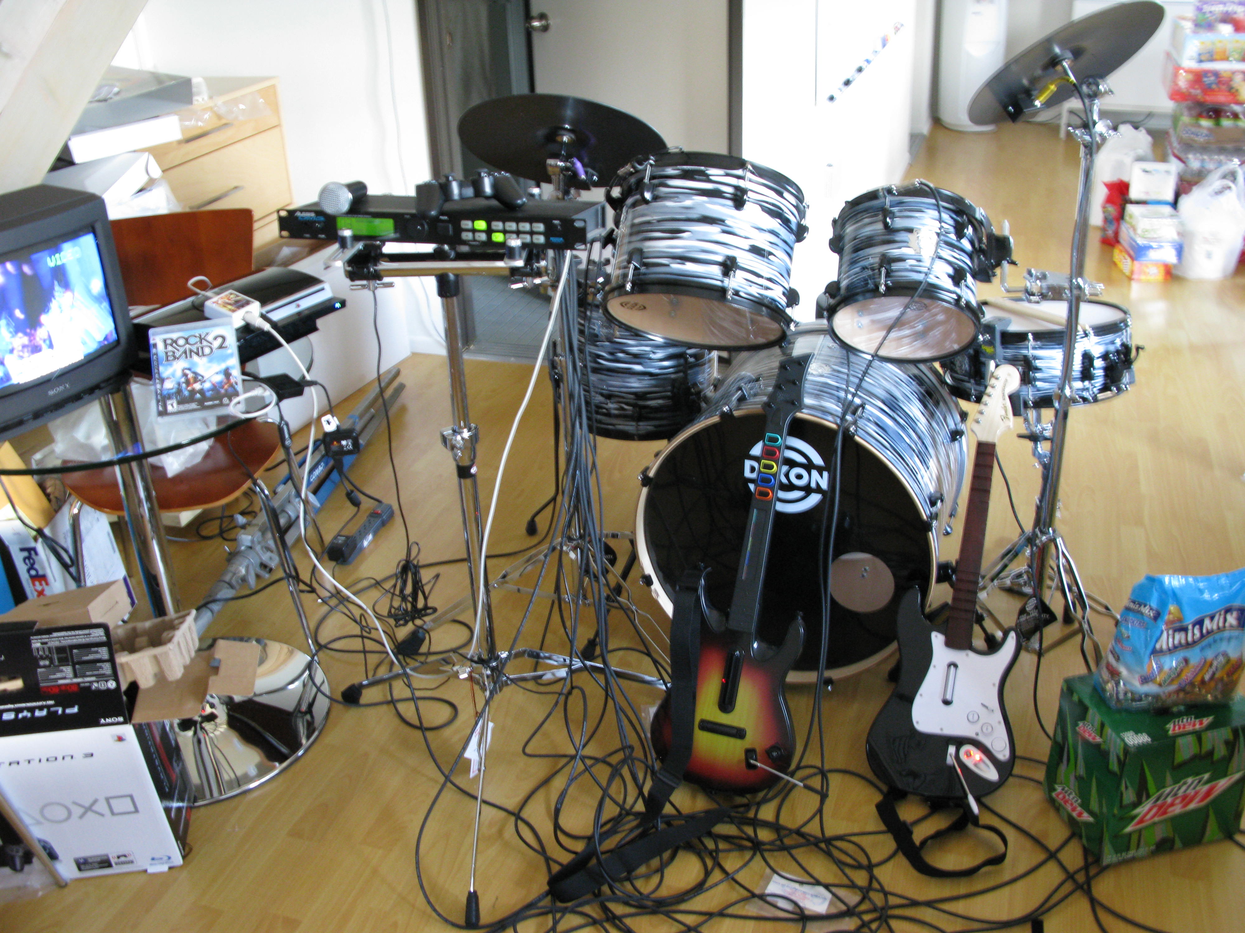

Step 10: Mount and Connect the Triggers
Mount the triggers to the drums and connect them to the trigger interface. We used the Alesis DM5. You can also use the Alesis Trigger I/O, Roland TD-3 or Roland TMC-6. Connect the trigger interface to the USB adaptor, and the USB adaptor to the Playstation 3.
Step 11: Configure the Interface
Set up your drum trigger interface to trigger the correct midi note numbers as described by the USB adaptor interface. You can start the game to test the triggers. You may want to put the game in the no fail mode so you will not need to keep restarting the song. Adjust the crosstalk and gain setting in the drum trigger interface.
