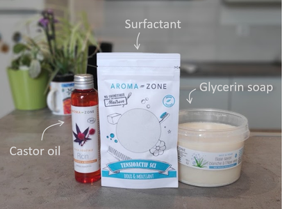

  • 100 grams of glycerin soap
  • 30 grams of surfactant. I use SCI surfactant, but others will probably work to.
  • 3 grams of castor oil
  • some perfuming drops (optional)

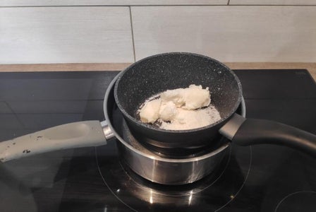

Step 2: Prepare Your Bain-marie
Fill half the big pot with water. Place the small pot so that it floats in the water. Turn on the heat.

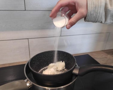

Step 3: Melt Glycerin Soap and Surfactant
Add the glycerin soap and the surfactant to the pot.
Heat them in a bain-marie. Melt them and stir frequently with a spatula.
In around 10 minutes, it will become a uniform mixture.

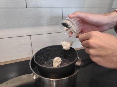

Step 4: Add Castor Oil
Add castor oil. Then mix until you have a homogeneous mixture.
