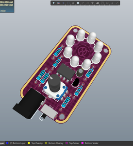

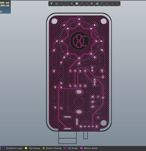

I moved to altium designer and I brought the LM358 amplifier from the online library, it comes with its inner dual amplifier blocks displayed separatly so it helps me in the schematic wiring, after establishing the parts connection I then transformed the schematic to a PCB design and I performed some PCB art drawing in there to give a cool looking to my circuit board.
Step 2: Prepare for Assembly
After getting the design ready, I then moved to JLCPCB where I uploaded the GERBER files of my design to get them produced, I selected the purple soldermask color for this circuit but you still can select whatever color suitable for you.
As soon as I received the PCBs I set my desktop for the assembly and I brought the tools to solder the electronics parts each to its placement on the board.

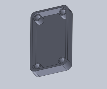

Step 3: Make the Housing
A good housing is always an advantage to your device so I advise that you design the circuit related housing and 3D print it the way I did, I used a polywood Filament to produce this housing which gives the device a better appearance then I used 3mm threaded inserts to help me screw the board to the housing and finally the device is done and ready.
