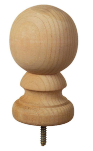

  1. 4x4 Round Wood Post Top (Home Depot has them: Model #102615; Store SKU #429323)

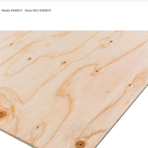

  3. 1/8 inch plywood, roughly 2 feet x 2 feet

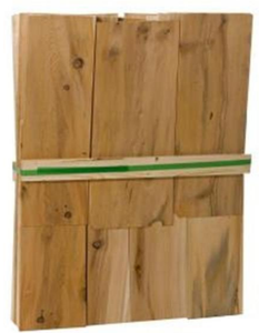

  5. Cedar Shingles (Home Depot sells them: Model #CSSHDSHAU; Store SKU #873969))

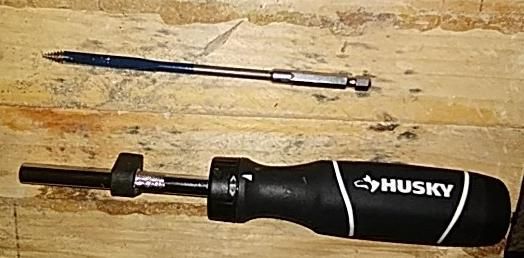

  7. Hand drill and drill bit

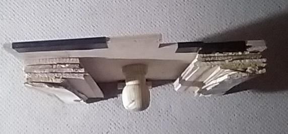

Step 1: Attach Wood Post Top & 2x4
  1. Use drill bit to start hole for wood post top screw
  2. Screw wood post into board until wood base is flush to the surface
  3. Screw will protrude from the other side
  4. Use 2x4 to cover and anchor screw
  5. Rotate wood onto screw until flush

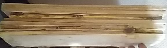

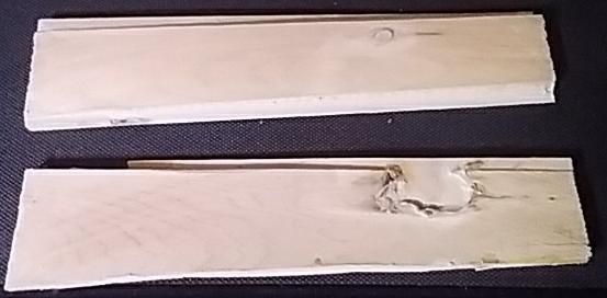

Step 2: Glue Cedar Shingles Together
  1. Take 2 cedar shingles and glue them together to make 1 piece of wood.
  2. Repeat this to make 10 to 12 pieces.
Step 3: Glue Cedar Shingles to Board
  1. Glue cedar shingles one at a time to side of board with round post top.
  2. Keep adding shingles until you have about 6 shingles on the left and right sides.

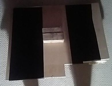

Step 4: Apply Rubber Tape
  1. Apply rubber tape to left and right side of top of board.
  2. This will make it easier to stand on the board with bare feet.
