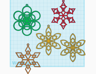

Step 1: Files
You can make your own designs, but here are mine if you want them.
Remember, they are only .8mm thick but you can change that in the slicer or upload them into Tinkercad and thicken them.

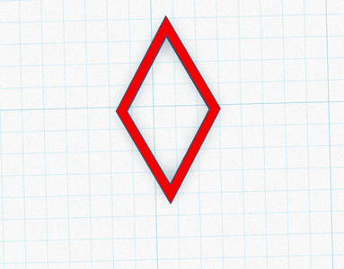

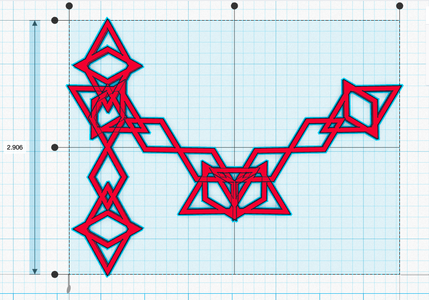

Step 2: Start Your Snowflake "arm"
I designed my snowflakes using Tinkercad.
To make things easier, I made basic snowflakes made out of a single geometric shape each.

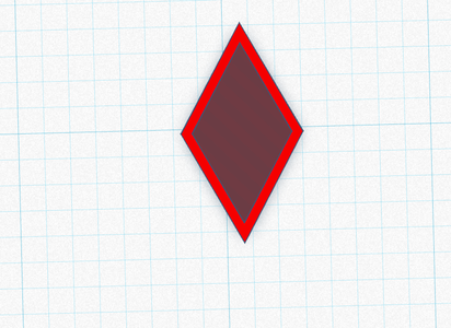

Start by "hollowing out" the shape you want to work with, I'm working with a diamond.

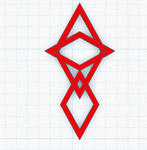

Copy, paste, and rearrange your shapes until you have a snowflake arm that you like. Make sure they are all the same thickness and they are all lined up (if that is how you want them), then group them together.
Step 3: Top and Bottom

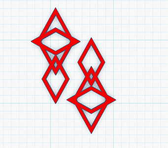

Once you have 1 arm, you can copy, paste, and rotate it 180 degrees.
Line them up the way you want and make sure they are aligned using that function.
Now you'll have the top and bottom of the snowflake. Group it all together.

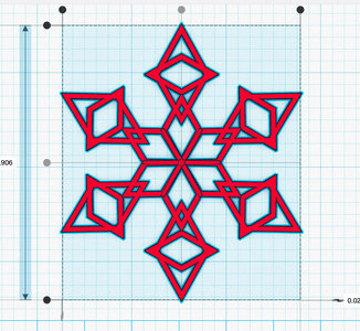

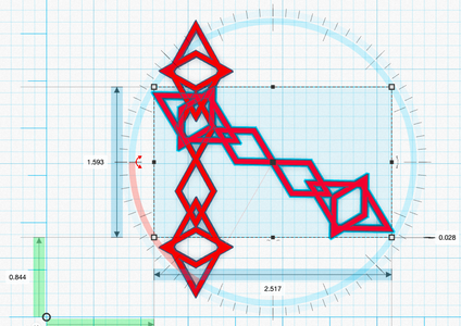

Step 4: Make It 6 Pointed
Now all you have to do is take your top and bottom shape, copy it and rotate it 60 degrees. Take this rotated shape and copy it and rotate it another 60 degrees.
Take all three of these shapes and align them top and bottom / left and right.
Group it and you have a snowflake!

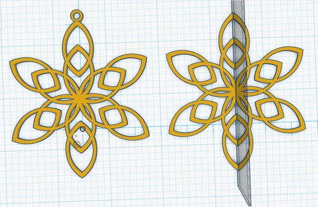

Step 6: 3D Snowflake
If you want the snowflake to be more 3D, an easy way to do this is copy and paste your snowflake design (minus any loop).
Now using a long thin rectangle, cut out the exact center of the snowflake. Mine was only 0.76mm. You don't need to cut out a lot.
Just print out the full snowflake with the loop, and the snowflake that has been cut down the middle.
