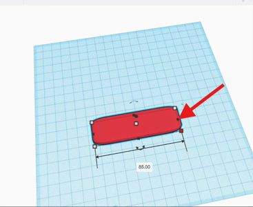

Step 5: Adjusting the Length
Next, click and hold the black square on the right side of the cube, adjust it’s length to “85.00mm” you can either adjust this with your mouse or type in in to the dimensions like we did for the radius.

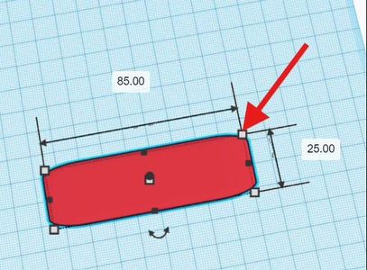

Step 6: Adjusting the Width
After adjusting the length, you will want to adjust the width. Click on the white box above the black dot and adjust it to “25.00mm”. After you’ve done this, you should have the perfect length, width and height for your keychain.

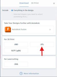

Step 16: STL File
Next you’ll be sent to this prompt. Press ”.STl” this is the specific printing file for a 3D print.

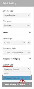

Step 18: Breakaway Supports
Once your keychain is in the workplane, on the right side of the screen, you should see a gear icon. his will open up your print settings. Under the support type, select Breakaway Support. This ensures that your print will look exactly how it looks like on your computer. If you don’t use Breakaway support, you can risk your print becoming droopy. No one wants that! Once ready, press print.
