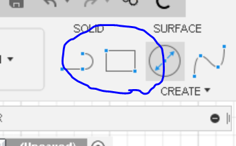

Step 6: Revolve You Pulley
Next, select the "Revolve" tool from the tool bar and click on the square body you made with the groove in it. then click on the Y axis running through the origin. Next a box will appear asking for you to enter how many degrees you wish to rotate your pulley by. Type "360" in the box and click enter.
Your sketch should have rotated 360 degrees as did mine in the image above
