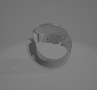

  1. I started with a Top Plane sketch and drew a large circle (50mm diameter) to form the base of the watch. This size fits most wrists without feeling too bulky or too small.
  2. Using Extrude, I gave the circle a thickness of about 10mm to give it that solid, chunky Omnitrix feel.
  3. On top of the base, I created a smaller raised platform right in the center, which is where the iconic green hourglass dial would sit. I extruded it slightly higher (about 2–3mm) to make it pop.
  4. For the dial shape, I created a new sketch on the top face of that raised platform. I drew one half of the hourglass, mirrored it, then used Offset and Extrude to bring the shape to life.
  5. I added side knobs to mimic the show, just simple cylinders extruded from the sides of the base. These give the watch a more functional, techy vibe.
  6. For the straps, instead of printing them separately, I designed curved extensions with gaps on both sides of the base so that I could loop in Velcro or elastic after printing. This keeps the design fully wearable without needing extra hardware. Also, if you think the wrist size is too small to fit you, then you can make some modification to the design and adjust the strap size.
  7. I used the Fillet tool to round off sharp edges, especially where the watch touches your wrist, so it’s comfortable to wear.
  8. Even though this is a single model, I wanted it to look like it had multiple components. So I assigned black and green materials in Fusion 360 using the Appearance tab. This helped me visualize where I’d later do the filament swap during printing, black for the main body, and bright green for the dial.

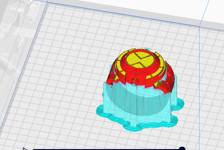

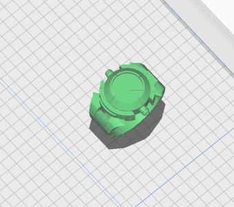

  1. Now that the STL was ready, it was time to prepare it for printing, This is where slicing comes in. I used Ultimaker Cura, which is free and works well for standard FDM printers, even if you only have one extruder. Since I wanted to print my Omnitrix with two colors (black and green) in one go, I had to plan the slice carefully to know exactly when to change filament.
  2. I laid the part flat on the bed so the bottom surface would stick well and the dial would print on top.
  3. Cura automatically oriented it correctly, but I double-checked that the dial was facing up. this is important because we’ll be swapping filament partway through the print.
  4. Layer height: 0.2 mm
  5. Wall line count: 3 (for better strength)
  6. Infill: 15% (you can go higher if you want it more solid)
  7. Supports: Not needed (my model was flat and support-free!)
  8. Print speed: 50 mm/s
  9. Material: PLA
  10. Nozzle temp: 200°C
  11. Bed temp: 60°C
  12. Build plate adhesion: Brim (just in case)

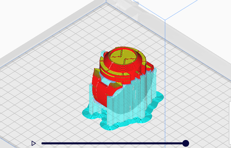

  13. Here’s the cool part, even with a basic single-extruder printer, you can still do multicolor. I used Cura’s “Pause at Height” feature to pause the print right when the green dial started, so I could manually swap from black to green filament.
  14. In Cura, after slicing, I clicked the “Preview” tab.
  15. I dragged the layer slider to watch the print build up, and found the layer where the dial begins.
  16. For me, it was around Layer 42, but it’ll depend on your specific model and slicing settings.
  17. I went to Extensions → Post-Processing → Modify G-Code.
  18. Clicked “Add a script” → “Pause at height”.
  19. Entered the exact layer number, selected Z-axis height, and added a custom pause message like:
  20. "Swap to green filament for the dial."
  21. Saved and re-sliced the model.
  22. When the printer hit that layer, it paused. I unloaded the black filament, loaded green, purged a little, and hit resume. Simple!
