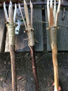

Step 1:
Split the end of your stick in to 4ths. Tie cord as tight as you can around were you wants the splits to stop. That stops the stick from splitting further.

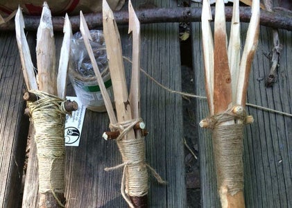

Step 2:
Jam the two twigs in to the splits to keep them open then tie cord around it to keep them from coming out.
Step 3:
Sharpen the points and make notches in inside points so the fish don't come off.
