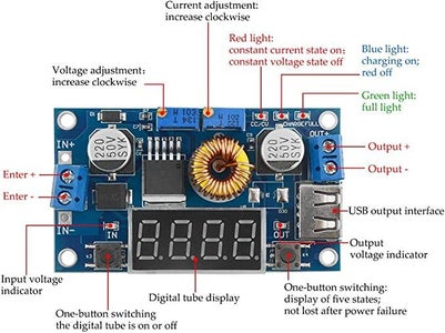

Step 13: Battery and Buck Module
Crimp your connectors for the battery on the wires. Connect the other end of your wires to the buck module.
!! CONNECT NOTHING TO YOUR BUCK MODULE OUTPUT (yet) !!
You don't know where the screw is set that sets the output voltage (and current, but not as important). You could connect something at 12v and blow it up.
IT IS IMPERATIVE you screw the voltage screw as anti-clockwise as it will go, as a baseline.
Next, connect something you don't care too much about (a fan I have here in the pictures).
The voltage has to be set correctly - the current will alter itself based on what it draws, so we're not too worried about that.
Set the voltage to 5.1v using a screw driver on the left blue component shown in the diagram.
