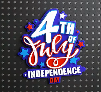

Let’s craft a laser cutting 4th of July Decoration!
This bold and festive design brings patriotic flair and layered charm together, and it is perfect as a vibrant centerpiece for your celebration, a cheerful addition to your home décor, or a spirited gift that lights up any Independence Day celebration.

Step 6: Assemble the 4th of July Decoration
When the acrylic laser cutting is complete, it’s time to bring your 4th of July decoration to life. Remeber, assemble it layer by layer.
Start by gluing the light blue and red pieces on the navy blue base, making sure to align them precisely with the outline for a clean look. Next, place the white “4th of July” lettering as the top layer to make the design pop. Finally, don’t forget to finish it off with the small stars around the edges—they’re the perfect final touch to complete your festive masterpiece.
assemble 4th of July decoration
