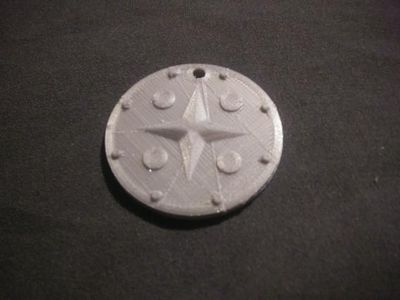

This is everything done except for the hole, if you want to change anything it as simple as ungrouping and making the appropriate changes. If you are happy with your model then all that remains is to put a hole in it.
Step 5: Final Touches
Almost there!
Once you are happy with your model the final step is to add a hole to the amulet so that you can put it on a necklace.
This is simple to do, all you have to do is make a cylinder "Hole" feature with a 1/8th inch diameter and place it along one of the edges and all the way through the amulet then group the features and you have a completed model.

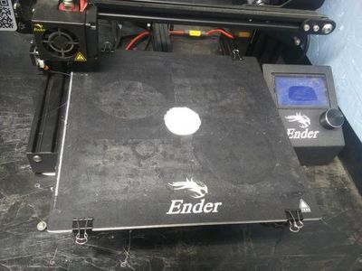

Now that you have the model in Tinkercad you can select "export" in the top right corner. You will want to export it as a .STL file.
From here you can 3D print it with the slicer of your choice.
the settings are not very important if you intend to cast this but if you intend to just use the 3D print make sure to make it strong enough to handle some wear and tare.
Important Note: if you are using an FDM 3D printer a 0.4mm nozzle will work but a smaller nozzle will result in finer detail. If you have a resin printer this is a very resin printer-friendly project and that will yield better results if using silicone.

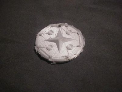

Once you have printed the amulet you will likely have to clean it up, this is easy and most includes removing any stringing and cutting off any seams. This can be done with a razor blade and some flush nippers pretty easily but I was able to do it fully by hand.
Something you can do is sand all surfaces smooth if you choose but I did not find it necessary.

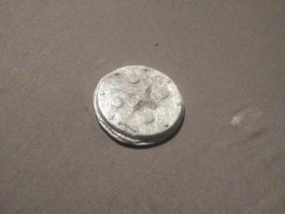

You could make a mold with silicone or plaster and cast it in metal or resin, you could make wax copies and make multiple castings, you could take the print and electroplate it through a few methods that can be found online.
I choose to try and cast mine and made a mold from it. In my case I could not get a good casting but a better set up or more skill could easily do so.
